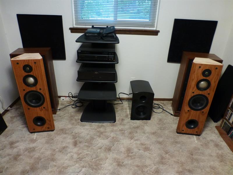

Ratamahatta 437 Posted October 8, 2014 Author Posted October 8, 2014 I was talking about the dial on the L-pad should it be at 12 0 clock for neutral. Turns out this was correct. I have them tilted slightly back. I will post pics when they are complete this weekend hopefully or latter on when I get some time, Thanks again. OK I lied, some pix

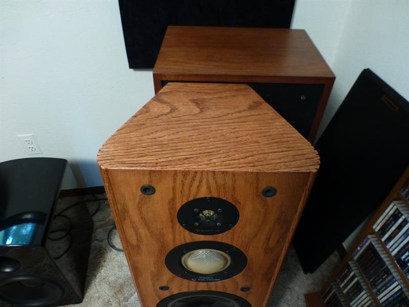

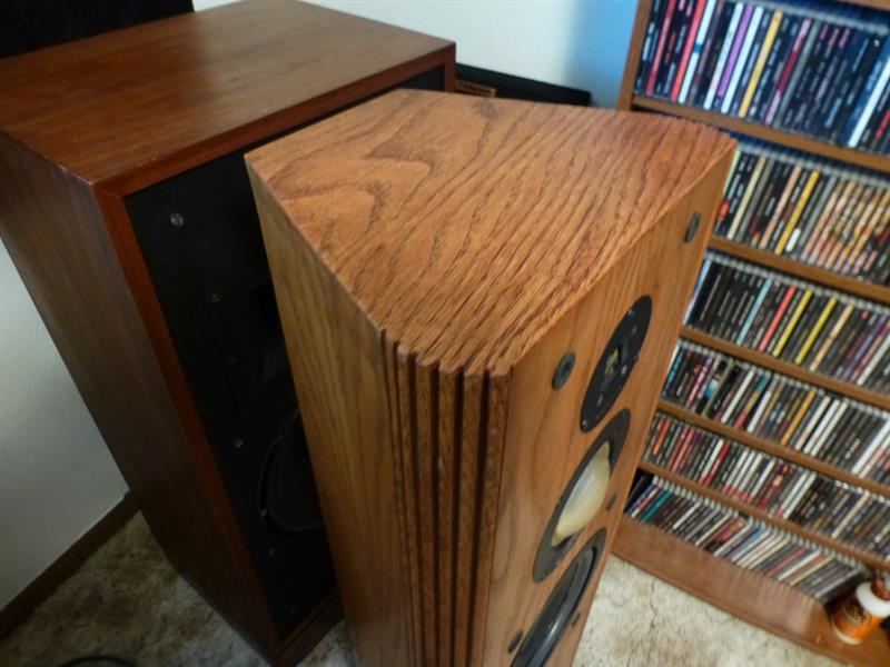

Ratamahatta 437 Posted October 10, 2014 Author Posted October 10, 2014 OK got one done except for putting the clear protective wax on the top when the stain dries. The Veneer I got was thicker to the point where you could trim it with an X-acto knife. Nice veneer but I had to trim it with a sander, then sand the veneer with the orbital sander after I glued it on. I already had some wood glue so I tried the clothes Iron technique and it worked out great. I was skeptical at first but it worked like a charm. cutting the fingers out on the sides was kind of tricky, I used a Dremel and a small sharp bit. The guy I got the veneer from accidentally shipped one instead of two so I will do the next one when it gets in. Its a shade off but all in all I am happy with the results. At the least I saved them from certain death. And so far still really impressing me, we will have to wait and see how they compare to everything else I have. 1

zumbini 6,153 Posted October 10, 2014 Posted October 10, 2014 OK got one done except for putting the clear protective wax on the top when the stain dries. The Veneer I got was thicker to the point where you could trim it with an X-acto knife. Nice veneer but I had to trim it with a sander, then sand the veneer with the orbital sander after I glued it on. I already had some wood glue so I tried the clothes Iron technique and it worked out great. I was skeptical at first but it worked like a charm. cutting the fingers out on the sides was kind of tricky, I used a Dremel and a small sharp bit. The guy I got the veneer from accidentally shipped one instead of two so I will do the next one when it gets in. Its a shade off but all in all I am happy with the results. At the least I saved them from certain death. And so far still really impressing me, we will have to wait and see how they compare to everything else I have. Nice work Ratamahatta! FYI: Adding a drop or two of red to the stain will warm it up bit. 1

PMAT 2,060 Posted October 11, 2014 Posted October 11, 2014 Wow, great selection of veneer! You matched the grain really well. If you get the color closer it will be hard to tell that you repaired it. 1
Ratamahatta 437 Posted October 11, 2014 Author Posted October 11, 2014 Thanks, I have a bunch of wax at work that works great on sealing and protecting wood. I sanded a piece of scrap veneer and will experiment next week. But if this as good as it gets then I am OK with that too. My goal was to make them look better than when I got them. My living room is always dark and I bet most people would never even notice. For now these are going to be keepers and might even be in the top three. These might even sound better than the 8.1's did, well at least in my living room, those things needed a bunch of space. I am sure they had better bass but that;s what subs are for. I also had some Infinity QLS but got rid of those too just because don't have the space for their full potential and I got tired of speakers you need a hand truck to move around, lol. I am finding out that I just don't need speakers that big to achieve the sound I want anymore. If I want loud then the Klipsch it is. I hear you, so many speakers to few rooms. If I ever won the lottery I would buy a 27 room house. but I guess I would actually need to play for that to happen.

Ratamahatta 437 Posted October 14, 2014 Author Posted October 14, 2014 Well it seems the red wax did the trick. 3
DaveStL 85 Posted October 14, 2014 Posted October 14, 2014 The trick behind some of Infinity's speaker designs is if you have them positioned correctly, "from the sweet spot" the sound stage is awesome. Spooked the 5hi7 out of me the first time I heard it, vocals were coming from in between the speakers (center stage). That's imaging! On a good recording, you can close your eyes and point to each voice or instrument across the stage, know how wide it is and how far away.
zumbini 6,153 Posted October 14, 2014 Posted October 14, 2014 Well it seems the red wax did the trick. Great match! Nicely done Ratamahatta. 1
Ratamahatta 437 Posted October 14, 2014 Author Posted October 14, 2014 Thanks considering what they looked like before I could not be happier with the results, the other veneer should be in today. Now just to do the other one. This thread should be a warning for everyone that lets the wife put plants and stuff on their speakers, its sacrilege, lol
