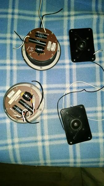

trav0810 589 Posted January 22, 2015 Posted January 22, 2015 Thanks to AndrewJohn, I have a soldering iron on the way! So, I am going to attempt my first crossover repair. It is the extremely advanced and complicated Polk Audio Monitor 5a crossover. 2 caps and 2 resistors per crossover. That's right gents, I am a risk taker! I'm not going to spend a fortune on these. I'm not a big believer in the extra money for TOTL caps and resistors. I figure any new. in spec caps HAVE to be better than the 25 year old caps that are in there, right?

oldtexasdog 2,583 Posted January 23, 2015 Posted January 23, 2015 All caps and resistors are not created equal. While you don't want to go crazy on your first run at it at least get the ones that are specs, at 1% so you wont have a lot of variance.
trav0810 589 Posted January 23, 2015 Author Posted January 23, 2015 All caps and resistors are not created equal. While you don't want to go crazy on your first run at it at least get the ones that are specs, at 1% so you wont have a lot of variance. 1%? Most of the Poly caps I have looked at were 3-5% and the Electrolytic were 6%
oldtexasdog 2,583 Posted January 23, 2015 Posted January 23, 2015 Get a couple of them then and take some measurements and put in the best matched pairs. Many sellers will have a set of matched pairs for just this type of project. One example. Datasheets Accu-F/Accu-P Product Photos Accu-P 0201 Product Training Modules Component Solutions for Smart Meter Applications Standard Package 5,000 Category Capacitors Family Thin Film Capacitors Series Accu-P® Packaging Tape & Reel (TR) Capacitance 10pF Tolerance ±1% Voltage - Rated 10V Mounting Type Surface Mount Package / Case 0201 (0603 Metric) Operating Temperature -55°C ~ 125°C Features RF, High Q, Low Loss Size / Dimension 0.024" L x 0.013" W (0.60mm x 0.33mm) Height - Seated (Max) 0.011" (0.28mm) 1

trav0810 589 Posted January 26, 2015 Author Posted January 26, 2015 I'm removing a 6.2ohm resistor, can I replace it with a 6.5?
fill35U 1,850 Posted January 26, 2015 Posted January 26, 2015 I doubt you'd hear a mere 5% difference. Many power resistors have a 10% tolerance anyhow. If it bugs you, a 2.7 in series with a 3.3 would get you 6.0, a little closer. And each could be half the wattage of the original 6.2 . Kinda hard to know which way to err unless you knew how the designer decided on the original value.
