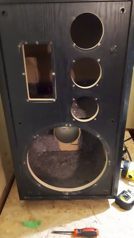

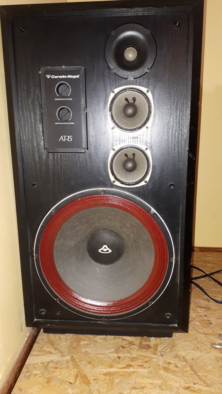

Carverpro 673 Posted April 1, 2019 Posted April 1, 2019 So to get the best possible sound I have decided to modify my At-15's. Top pic is how it sits now. Se-380 woofer in at-15 cabinets for stronger bass response. Note the difference between mid size between the at-15's and se380's. And the difference between the 2 woofers. 2 2

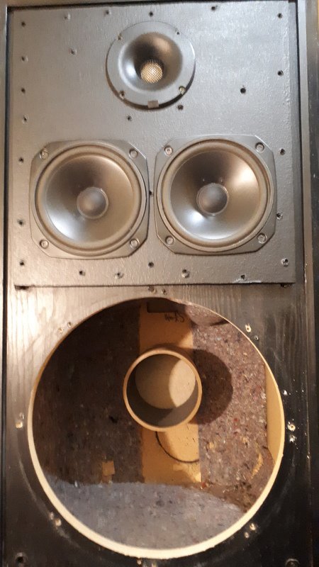

Carverpro 673 Posted April 1, 2019 Author Posted April 1, 2019 (edited) Two different type of tweeters. I went with the At-15's. Took out all the drivers and wiring . Built a custom set of front baffles out of 3/4" mdf all ready to be cut out and transplanted into the front of At-15 enclosures. I would have preferred the same midrange/ tweeter positioning as stock...but the se380's are massive compared to the At15's....so I had to re- design it. Edited April 1, 2019 by Carverpro 1 3

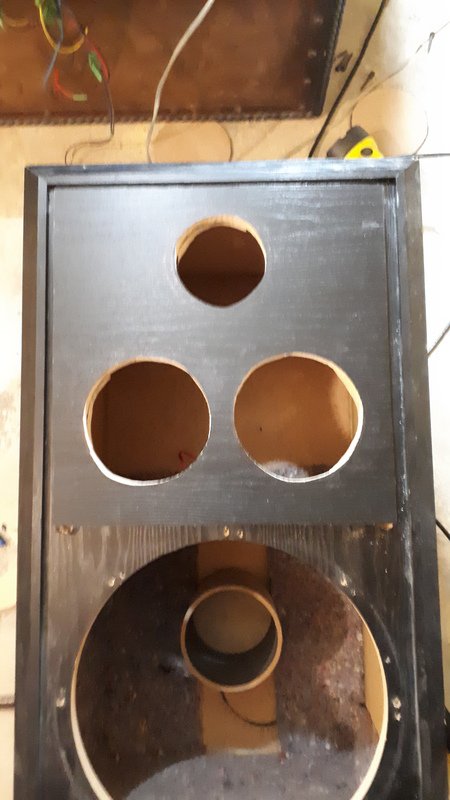

Carverpro 673 Posted April 3, 2019 Author Posted April 3, 2019 (edited) New front baffle is in place. All that is needed to do now is silicone and screw it down. Change the internal brace location. Move the crossover and mid/tweet controls to the back of the outside box...pump about 500 watts into it and check for rattling noises coming from the new baffle. Already had the drivers in place. Measuring the distance from the dustcap on the woofer cone to the dustcap on the midranges to the center of the tweeter diaphragm on both speakers to make sure everything is identical. Edited April 3, 2019 by Carverpro

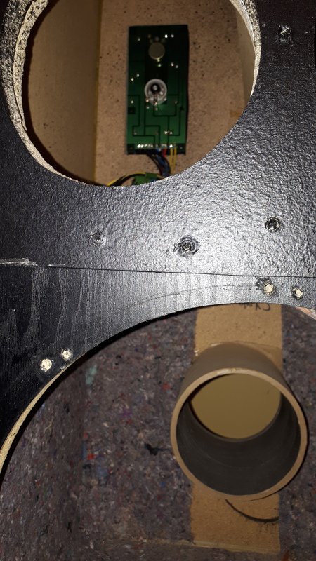

Carverpro 673 Posted April 3, 2019 Author Posted April 3, 2019 (edited) 7 hours ago, danowood said: Careful, speaker box's are designed for the characteristics of the drivers with a specific formula. having a tuned box to the drivers are of great importance. Looking good on your project, I wish you a successful journey in replicating the sound you seek. Yes I hear what you are saying. Now if the woofer is tuned to just the area behind the woofer( there Is carpeting that separates the woofer compartment from the mids and tweet)....and port size/length...then there shouldn't be a problem. ...If the woofer is being tuned to the whole area inside the cabinet and port size/ length then it's going to move the tuning of the box up ever so slightly. If you look at the pic the new baffle is sitting on top of the old one that I modified to make room for the bigger mids / tweeter location. It is 3/4" thick. ....Going by my subwoofer box building and tuning days...taking into account that the bigger size 6.5" se380 mids are taking up a bit more of internal space compared to the 5" ones that once rested there...I believe it shouldn't affect the tuning any amount that's going to have a negative impact. ...Stock cabinet tuning was 28hz. The mids and tweet are sitting 3/4" higher on the face plate. That and the difference in basket size between the two mids...might bring the tuning up to 29hz at the most...I'm hoping. Bigger question is the re-arrangment of the mids and tweet. It will either make an improvement with the different placement and or bigger mids. I wont know until I hear it running. Edited April 3, 2019 by Carverpro 4

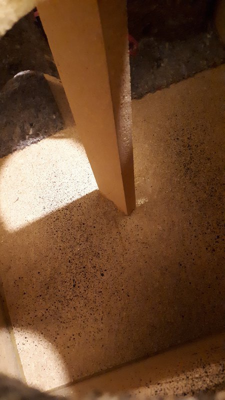

Bobby1970 1,831 Posted April 4, 2019 Posted April 4, 2019 13 hours ago, Carverpro said: Going by my subwoofer box building and tuning days ...you miss those days lol, please post pictures of the new bracing, thank you, "That Rocks" 3

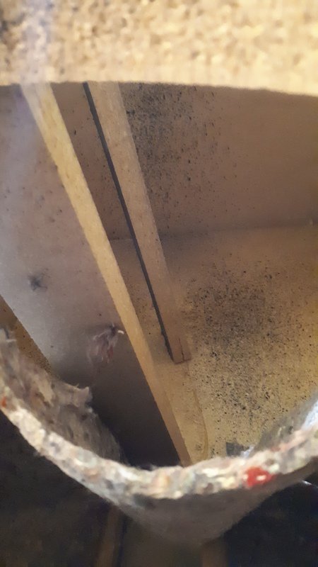

Carverpro 673 Posted April 4, 2019 Author Posted April 4, 2019 She ain't pretty...but the faceplate is strong and rigid. Plan on laying crushed velvet over it like on the se380's. But that's just for later....finishing touches. Have to first lay a healthy dose of carver power into them to check for unusual noises coming from the new faceplate. 1 1
Bobby1970 1,831 Posted April 4, 2019 Posted April 4, 2019 ...exactly what I am thinking for that kind of cabinet, thank you, hope you're not forgetting some glue..maybe this track may help check some things.. 1
Carverpro 673 Posted April 5, 2019 Author Posted April 5, 2019 Relocated the crossover/controls to the rear of the cabinet. All I have to do now is lengthen the crossover wires...install the drivers and wake the dead with about 500 watts. 3

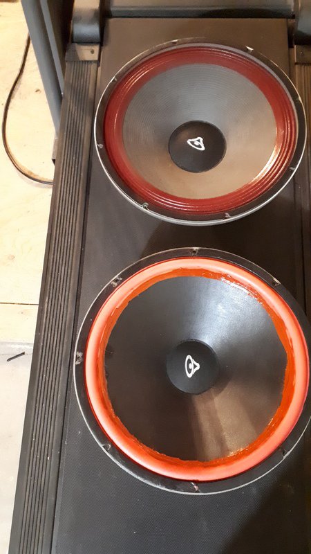

Carverpro 673 Posted April 5, 2019 Author Posted April 5, 2019 You can try what I used. Dont laugh it worked excellent. Looks bad but is stronger than silicone i believe...red automotive gasket maker. Check out the pic in this thread of the at15 woofer. It's all around the surround. That's when my Carver pm1.5a ripped the surround from the cone.
johnrotten 1,112 Posted April 5, 2019 Posted April 5, 2019 I was thinking more along the lines of contact or rubber cement that would be easily cleaned up at next re-foam. Crappy Tire sells it too. I have had these speakers over 30 years now and re-foamed them twice using Simply Speakers products. No offense but the gasket maker looks like crap and probably will for the life of the cone, regardless of new surrounds. I will probably bite the bullet and order the SS kit now and an extra tube of glue. I found out the hard way that leftover glue doesn't stick and always use a fresh tube.
Carverpro 673 Posted April 6, 2019 Author Posted April 6, 2019 2 hours ago, johnrotten said: I was thinking more along the lines of contact or rubber cement that would be easily cleaned up at next re-foam. Crappy Tire sells it too. I have had these speakers over 30 years now and re-foamed them twice using Simply Speakers products. No offense but the gasket maker looks like crap and probably will for the life of the cone, regardless of new surrounds. I will probably bite the bullet and order the SS kit now and an extra tube of glue. I found out the hard way that leftover glue doesn't stick and always use a fresh tube. True enough. It does look like crap...lol.I tried another adhesive before that and it didn't take. My plan was to change out the woofers so I wasn't really concerned how it looked at the time. I didn't expect the gasket maker to work neither...but it's been holding up to a lot of pounding. As a side note...both woofers were fresh refoams from a guy who has been freshening up cerwin vega woofers for 25 years. Couldn't handle the carver amp however .? 1
