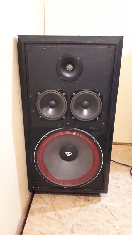

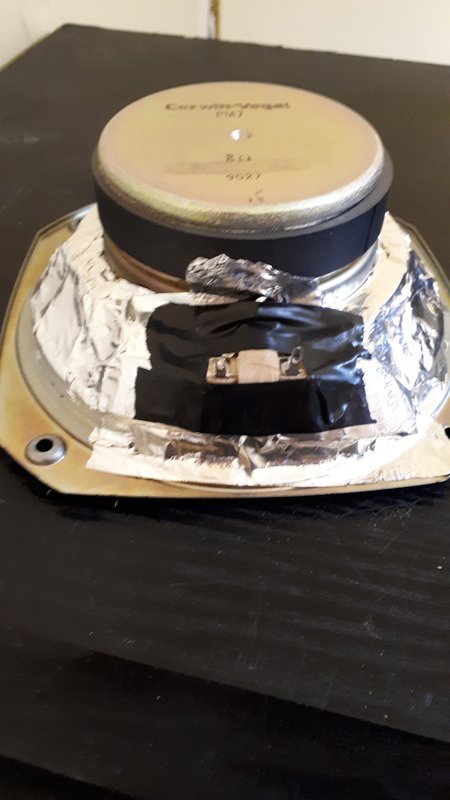

Carverpro 673 Posted April 7, 2019 Author Posted April 7, 2019 Ok I fixed the problem. I wrapped some clothes dryer hose aluminum tape around the basket holes sealing them up. I then made a little wall strip (lip )out of cardboard to seal up the gap around the positive and negative wire terminals...just like the at15's mids. ...I then pumped about 500 watts through the speakers. No midrange cone movement. My god these things are intense. I put on some rap/dance to check for any rattles from the new faceplate I fabricated...nothing. vocals are loud and deep bass response. Feels like I have a huge sub in the room. Very beefy looking. Have to wait till Monday to post a few pics. --------- I need to talk to someone about impedance. I have never seen the following...each speaker has two 8 ohm mids wired in parallel for 4 ohms. When I went to connect the speaker wires to the mids ...on the - and + terminal...they have a big black dot " over " the positive terminal!?? Is this a screw up from cerwin vega during assembly? All 4 mids are done like this. ...I followed the same set up as on the at 15 mids. I went by the actual - and + terminal markings ignoring the black dot over the positive terminal. So right now I am either running 4 or 16 ohms for the mids. How can I tell which way is correct?? The tweeter is 4 ohms...as is the woofer. If the mids are at 16 ohms...what's the overall impedance? Thanks....

Carverpro 673 Posted April 7, 2019 Author Posted April 7, 2019 Tracked down some crushed velvet. I can get black or red. Hmmmmmm...black bottom where the woofer goes and for the new faceplate I made....perhaps red with the black mids and tweet might look killer. Make these Cerwin Vega monsters look really unique and stand out...what do you think? Or just keep it traditional black? 1

Daddyjt 10,062 Posted April 8, 2019 Posted April 8, 2019 They look eerily familiar, lol. How do they sound? 1 1

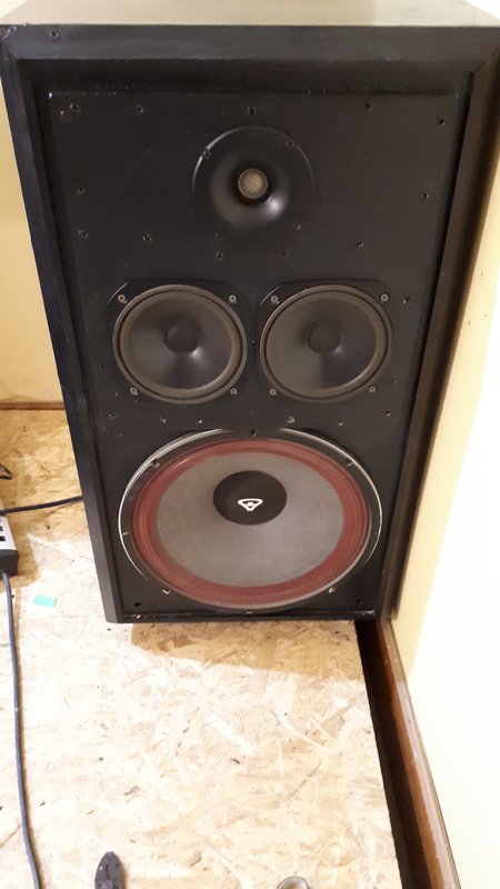

Carverpro 673 Posted April 8, 2019 Author Posted April 8, 2019 (edited) 57 minutes ago, Daddyjt said: They look eerily familiar, lol. How do they sound? They sound awesome. The bigger mids definately strengthens the vocals. Surprisingly the image has improved. The sound is more centralized. Last night was the first time I had a chance to beat on them for about 5 hrs. On hour 3 of listening to deadmause at 400+ watts...I heard a rattling coming from the right speaker.. sounded like a voice coil failing. Fortunately, it was the cabinet itself. I pushed in on the back panel and the rattling went away. Guess I have to beef up the bracing. Listening to Neil young was insane! Edited April 8, 2019 by Carverpro 1 2
Carverpro 673 Posted April 8, 2019 Author Posted April 8, 2019 This is the extremes I had to go to for the mids. Had to totally seal up the holes in the basket and the gap behind the wire terminal leading into the spider and such. Very crude looking but very Effective. I can not imagine this hurting the sound quality...but i could be wrong? 1 1
Brian_at_HHH 2,754 Posted April 8, 2019 Posted April 8, 2019 All I can say is WOW - beautiful work! And I'm really glad to hear how fantastic they sound. All in all an amazing project - thanks for letting us follow along. 1
Daddyjt 10,062 Posted April 8, 2019 Posted April 8, 2019 4 hours ago, Carverpro said: This is the extremes I had to go to for the mids. Had to totally seal up the holes in the basket and the gap behind the wire terminal leading into the spider and such. Very crude looking but very Effective. I can not imagine this hurting the sound quality...but i could be wrong? Do the mids not have their own sealed chamber?
Brian_at_HHH 2,754 Posted April 8, 2019 Posted April 8, 2019 @Daddyjt if you go WAY back in this, you'll see that there wasn't a separate chamber for the mids, and that Carverpro was worried about changing the acoustic effect if he created one. He found that without something to baffle the back of the mids the woofer was pushing them, as you might expect with something that big, and the air it moves.

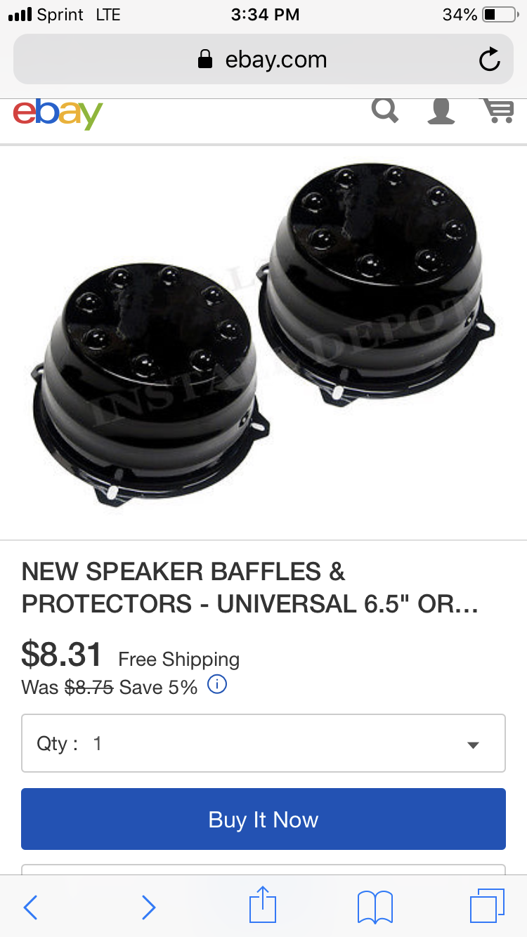

Daddyjt 10,062 Posted April 8, 2019 Posted April 8, 2019 58 minutes ago, Brian_at_HHH said: @Daddyjt if you go WAY back in this, you'll see that there wasn't a separate chamber for the mids, and that Carverpro was worried about changing the acoustic effect if he created one. He found that without something to baffle the back of the mids the woofer was pushing them, as you might expect with something that big, and the air it moves. Ok, that makes sense - sorry for the oversight. In that case, maybe something like this might be a better permanent solution... https://www.ebay.com/itm/NEW-SPEAKER-BAFFLES-PROTECTORS-UNIVERSAL-6-5-OR-5-25-PAIR-CAR-SPEAKERS/272892716727?hash=item3f89ac66b7:g:vagAAMXQMXRQ9HPN 2 1
Carverpro 673 Posted April 8, 2019 Author Posted April 8, 2019 8 minutes ago, Daddyjt said: Ok, that makes sense - sorry for the oversight. In that case, maybe something like this might be a better permanent solution... https://www.ebay.com/itm/NEW-SPEAKER-BAFFLES-PROTECTORS-UNIVERSAL-6-5-OR-5-25-PAIR-CAR-SPEAKERS/272892716727?hash=item3f89ac66b7:g:vagAAMXQMXRQ9HPN Yes...I was considering this option. Still may do it. I'm just glad I didnt have to rip that face plate off and build a sealed enclosure for the mids...and to be perfectly honest with you the mids in the at-15's had no sealed chamber behind them. The se380's " did " have small pods behind the mids packed hard with pink fiberglass insulation. I actually thought this was done for sound quality and not to keep the waves from the bass from interfering with mids performance. A critical error on my part. Luckily it got resolved.? 1

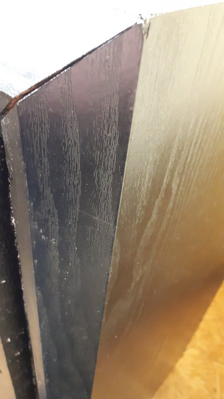

Carverpro 673 Posted April 9, 2019 Author Posted April 9, 2019 I guess 400+ watts from this Carver amp going into the cabinets for 5 hours at a time is proving to be too much. The speakers are starting to protest. Blew the upper right corner seam apart. 1
Brian_at_HHH 2,754 Posted April 9, 2019 Posted April 9, 2019 2 hours ago, Carverpro said: I guess 400+ watts from this Carver amp going into the cabinets for 5 hours at a time is proving to be too much. The speakers are starting to protest. Blew the upper right corner seam apart. OOPS! I guess we now know which seams you didn't reglue ... yet.
Carverpro 673 Posted April 9, 2019 Author Posted April 9, 2019 I never touched that part of the cabinet whe modifying. Trying to fix with glue, silicone and screws. 1
Carverpro 673 Posted April 13, 2019 Author Posted April 13, 2019 (edited) I spent all week fixing the upper split in the corner and doubling up on the bracing inside. Glued, screwed and siliconed. Made no difference whatsoever. When cranked the rear wall of the enclosure is rattling( slapping). And once again if I push in on the back hard the vibration disappears. I have no idea how to fix this? ...aside from sticking a 2×4 under the bottom woofer on the floor to prevent the speaker from moving ahead while I wedge a 2×4 in between the back of the enclosure and the actual wall(drywall)...lol. I guess modifying the At15 enclosures weakened the internal structural integrity. Time to built a set of enclosures from scratch. Edited April 13, 2019 by Carverpro 1
