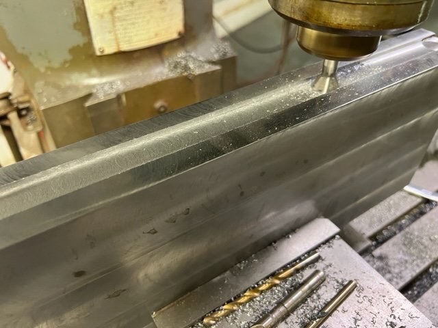

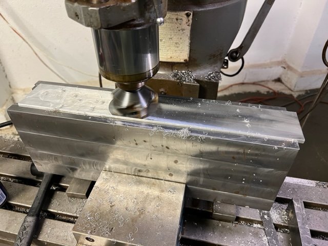

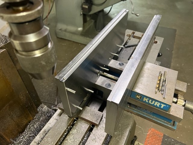

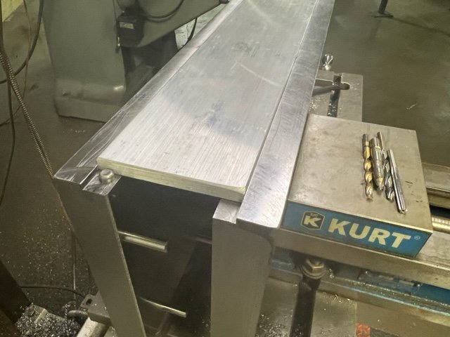

Ar9Jim 6,520 Posted September 21, 2023 Author Posted September 21, 2023 (edited) The work holding tooling is done. The fixture will work with a variety of chassis and faceplates. The chassis has blue tape to prevent the chips from scratching it. The aluminum face plate material has a solid stop for locating the blanks in position. The pocket the blanks set in, had the inside corners relieved with a dovetail cutter, so the plates will rest flat on the locating surface. The counterbored holes are for 1/2 socket head cap screws. Tomorrow the prototype parts will be machined. This fixture fits in the CNC mill for production runs. Edited September 21, 2023 by Ar9Jim 5
4krow 7,307 Posted September 21, 2023 Posted September 21, 2023 What speed does the machine run at to drill aluminum? 2
Ar9Jim 6,520 Posted September 21, 2023 Author Posted September 21, 2023 9 minutes ago, 4krow said: What speed does the machine run at to drill aluminum? It depends on the drill diameter. A Bridgeport mill like this has a 2 speed gear box. They can go from about 50 to about 2200 rpm. Very versatile machine. An old one like this can be purchased for about $3-4K. 5
4krow 7,307 Posted September 22, 2023 Posted September 22, 2023 In my shop, I have two drill presses. One is for power, the other for accuracy. 300-500 RPM is usually all I go with, but yes, then there are those cases that I am sure to want a higher speed. Kind of trying to get an idea about that. Seems like one of my presses will do 2700 RPM. Many times, I am using larger diameter bits or drill wood with a Forstner bit of 1/2" or more. Clamp it (with my hand, of course 😆) set the speed slow and have a bit of patience. With metals harder than brass that is when I will use some sort of proper lube just to save the bit. Was grinding down a shaft on an old Elma pot today. I don't what it was made of but it acted like stainless and took way longer to take a 32nd off of. Since the shaft was long, I could put it into a chuck of a hand drill held by a vise and then use a Dremel to work it down, finishing with a fine file and then diamond stone, it came out fine. 6
Ar9Jim 6,520 Posted September 22, 2023 Author Posted September 22, 2023 Here is a link to a calculator. These speeds would be under ideal conditions imho.. Solid mounted to the machine, peck drilling, flood coolant, etc.. I seldom run tools as fast as they say unless in a CNC machine. http://www.vikingdrill.com/fdspCal.html 3
4krow 7,307 Posted September 22, 2023 Posted September 22, 2023 Thanks Jim! I have not ever seen that detailed information, since I am usually/always using my best guess with my hand on the drill press lever. You have to bite or else you will only increase heat and no cut. You have not to bite too much or else you will cause some kind of quick trouble. I tend to let off the bit here and there to release heat from the bit and then back into it I go. Choice of drill bit can also be influential. We could go on and on here, but it interests me. Diameter, feed rate, material, speed. Kind of like racing but carefully on a track. 2

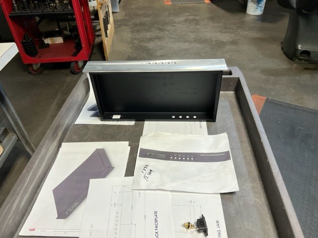

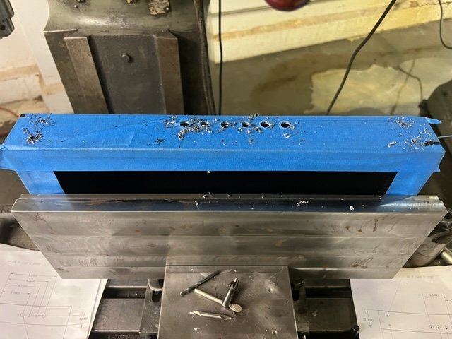

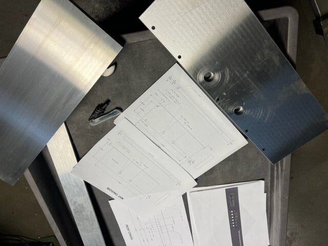

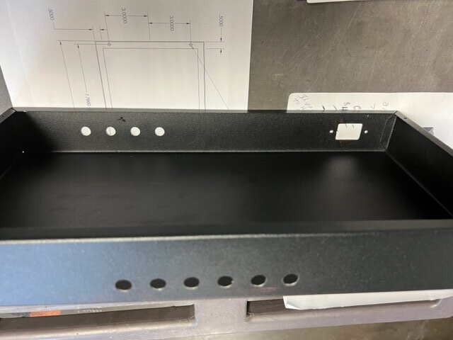

Ar9Jim 6,520 Posted September 26, 2023 Author Posted September 26, 2023 (edited) The work holding fixture worked very well for both the chassis and the faceplate. The chassis and faceplate machining is about complete. Some 6-32 threaded holes will be added to the back of the faceplate. The clearance holes are drilled in the chassis. This will keep the faceplate clean without screws showing. The button holes were radiused with a ball nose end mill to fit your fingertip like the V12. A few pictures of military aircraft with parts machined at this location and Plant 1. Used a face mill to clean up the 6061 aluminum. A corner rounding 3/32 R end mill was used around the edges to match the 285 and V12. The IEC socket clearance and screw holes were added. Close to metal finishing and silk screening now. Edited September 27, 2023 by Ar9Jim 4 2

jeffs 3,490 Posted September 26, 2023 Posted September 26, 2023 I always use blue tape on the faces then I'm using my crappy tools to drill holes in metal. thanks for the confirmation that I'm doing that part the correct way. 7

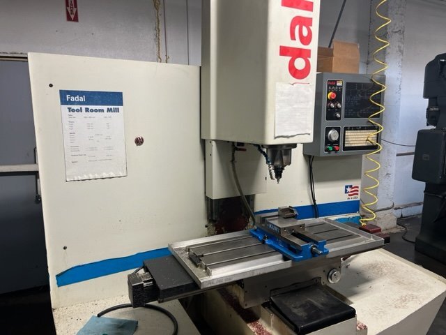

Yamacarver 840 Posted September 27, 2023 Posted September 27, 2023 The pictures of that old Bridgeport take me back a long time. The vari drive I think they called it, when you turn the wheel, one pulley widens, and the belt goes deeper in the groove effectively decreasing its diameter while the other pulley does the opposite. Mine had quick change collets like the NC tape reader equipped models that were soon replaced by the fadal vmc. 4
Ar9Jim 6,520 Posted September 27, 2023 Author Posted September 27, 2023 2 hours ago, Yamacarver said: The pictures of that old Bridgeport take me back a long time. The vari drive I think they called it, when you turn the wheel, one pulley widens, and the belt goes deeper in the groove effectively decreasing its diameter while the other pulley does the opposite. Mine had quick change collets like the NC tape reader equipped models that were soon replaced by the fadal vmc. Really great machines that still have a use. It's fun. There are not too many old guys left that know how to get things done using them. These that I have been using sit unused most of the time.. This small Fadal is handy for toolroom work and limited production.. It can be used manually or CNC. 5
