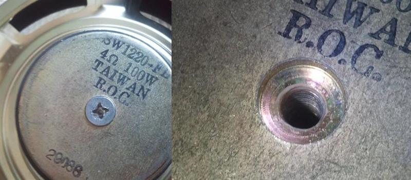

martin1970 361 Posted May 20, 2011 Posted May 20, 2011 Overheated voice coil? Is there a fix for this? Does the magnet assembly come apart? What's that screw for at the end of the assembly do? Not a huge fan of Orevox's price for these things. $90 last time I checked.
RichP714 3,177 Posted May 20, 2011 Posted May 20, 2011 The last time we did a group buy (I think we got them for $45) they said theye were going to go up in price due to scarcity. time to move on to newform research
kve777 6,910 Posted May 20, 2011 Posted May 20, 2011 Overheated voice coil? Is there a fix for this? Does the magnet assembly come apart? What's that screw for at the end of the assembly do? Looks like a loose magnet. They are usually glued in place. If you ship it to me I should be able to align it, epoxy it and get it going again. PM me.
mbskeam 1,995 Posted May 20, 2011 Posted May 20, 2011 http://thecarversite.com/yetanotherforum/default.aspx?g=posts&t=3804 reglue???.... been there done this..... they are still sounding good...... 1
martin1970 361 Posted May 20, 2011 Author Posted May 20, 2011 For some reason, I thought it would be a good idea to see if the scraping was on the in stroke or the out stroke of the woofer piston. Being the genius that I am, I loaded up Audio Test Bench and proceeded to send 20 Hz to the woofers. "Boy, isn't this fun, let's do 10 Hz." "Hey 5 Hz looks cool, I can almost tell when they're scraping." "Hmmm, nothing at 1 Hz, let's try 1.5 Hz. Cool, it scrapes on the way out." "Hey, what's that smell? Oh shit! varnish! fuckfuckfuck!" running for the power switch..... So now it's time to let things cool off and perhaps take up nail biting again... And perhaps switch to a smaller fuse. EDIT: Turns out the smell is coming from the other channel, which, thankfully, seems to be firing on all 4 cylinders.
martin1970 361 Posted May 20, 2011 Author Posted May 20, 2011 @mike&kev: All 8 woofers seem to have uneven stacks of magnets, But not one magnet would move when twisted pushed or pulled. There is also quite a bit of glue visible on all of the magnet stacks. Can these still be aligned? @mike: Very cool thread. Not sure how I missed that. Wrong search terms I guess. Did you make that tool yourself? Were all of the magnets that you reglued already free to begin with? Do you have a method for breaking them free without destroying the voice coil? @Rich: Those look really interesting but I'm afraid they may be beyond my budget. @all: What's up with the screw on the back of the magnet stack? Is the hole for some kind of puller?

kve777 6,910 Posted June 3, 2011 Posted June 3, 2011 I've been successful by screwing the speaker down on a workbench or table to keep it stable and prying up at two or three points around the seam where the magnet meets the basket with hard, sharp plastic, like ice scrapers. Apply even pressure to lever it upwards to clear the voice coil. Sometimes I have to do it a little at a time, shimming the gap with plastic or wood. Avoid screwdrivers or anything steel to pry or shim with, as the magnetic attraction complicates things. I'd like to hear Mike's method.

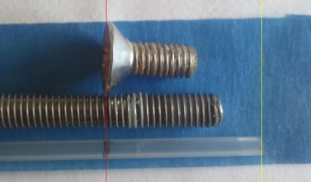

martin1970 361 Posted June 3, 2011 Author Posted June 3, 2011 Thanks for all the great suggestions. Tried the scrapers. Then graduated to prying on opposite sides with 2 big screwdrivers with tips covered in plastic. All that seemed to do was make the metal frame flex. Tried twisting. Even tried one of those jar opener lever things. Might borrow a strap wrench from one of the pipefitters at work. Looks like the glue is still pretty damned healthy. I'm still wondering about the hole in the end: Anyone know what it's for? Puller? Alignment during assembly perhaps? Here's more info about it: I tried threading a longer screw in as the thread seemed like it went all the way to the bottom. However either it didn't or there's 2 pieces that aren't fully aligned... The space between the red line and the yellow line is the hole depth. Yellow being the bottom of the hole, red being flush with the surface. On top is the original screw. The middle shows how far I was able to thread a longer screw before it stopped. The bottom piece shows the full depth of the hole. If I owned a rubber hammer, I probably would have knocked the crap out of this thing in frustration. Any more suggestions?

kve777 6,910 Posted June 3, 2011 Posted June 3, 2011 I'm still wondering about the hole in the end: Anyone know what it's for? Puller? Alignment during assembly perhaps? Here's more info about it: I tried threading a longer screw in as the thread seemed like it went all the way to the bottom. However either it didn't or there's 2 pieces that aren't fully aligned... The space between the red line and the yellow line is the hole depth. Yellow being the bottom of the hole, red being flush with the surface. On top is the original screw. The middle shows how far I was able to thread a longer screw before it stopped. The bottom piece shows the full depth of the hole. If I owned a rubber hammer, I probably would have knocked the crap out of this thing in frustration. Any more suggestions? I think it holds a slug inside the voice coil, probably to center it while the glue sets.
