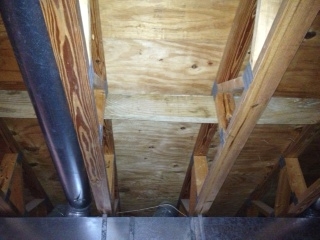

Retriever 1,145 Posted April 19, 2013 Author Posted April 19, 2013 I'm currently building a box to isolate the turntable. I work at a balance and vibration company, borrowed some equipment. I have a lot of bounce in my floor FFT graph shows low frequency resonance in the 40 to 30 hz region. Big bumps when someone walks in the room! As the house is trussed and no poles in the basement, covering a 48 x 25 area and an open floor plan, it acts like a trampoline. So I'm adding stiffening braces in the basement by the entertainment center. All goes well I should be solved this weekend.
Papajoe 221 Posted April 19, 2013 Posted April 19, 2013 If the isolation and stiffening elements don't completely do the job, you could cut a hole in the floor and build a concrete plinth up from piers anchored a few feet below the basement floor. Papajoe
Retriever 1,145 Posted April 19, 2013 Author Posted April 19, 2013 I wasn't planning on doing something that drastic!! However I was planning on picking up a basement pole at Home Depot or Lowes to put in the basement under the entertainment center. You should see the bumps in the freq plot when someone walks. I'm surprised the tone arm doesn't jump across the record! If I can figure out how to downsize the plots while maintaining readability I'd post them..
Retriever 1,145 Posted April 19, 2013 Author Posted April 19, 2013 Opps resonance is in the 65 hz region! Lower freq is footstep.
Retriever 1,145 Posted April 21, 2013 Author Posted April 21, 2013 All good added stiffening brace, way better just about done with box but need to give back a rest! Surgury 3 months ago 16 ft cross brace was a bit of a workout! Turntable is in cabinet working fine! Also increased tracking force to 1.5
