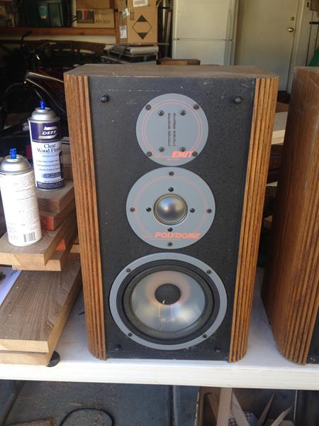

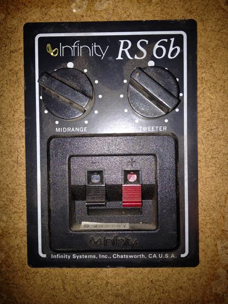

PMAT 2,084 Posted October 8, 2014 Posted October 8, 2014 Ok I am running with the theme here. A friend at work had these in his garage and brought them to me as a gift at work. They need some love as well. Overall they are in good shape. I need to learn how to do woofer surrounds myself. So here goes.

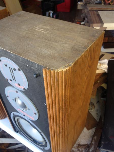

HappyTrails 498 Posted October 9, 2014 Posted October 9, 2014 Also, how thick is this veneer? Are you asking how thick because you want to sand or replace?
PMAT 2,084 Posted October 9, 2014 Author Posted October 9, 2014 Yes, I want to sand the tops. Some are too thin.

HappyTrails 498 Posted October 10, 2014 Posted October 10, 2014 Yes, I want to sand the tops. Some are too thin. No to sanding with anything that resembles course grit. You may have some luck steam ironing the veneer to remove, but hard to match the cabinet IMO when replacing. You might try rubbing the finish 00 to 0000 steel wool then using a oil similar to Danish Oil You'd either have to luck up and match the color or do the whole cab's Not sure how well this might work on worn veneer such as that but I used Howards on all my Infinity's throughout the years and it keeps them looking new. It might be that multiple rub downs with Howards will restore things?

PMAT 2,084 Posted October 11, 2014 Author Posted October 11, 2014 Just starting Gene. I started sanding the top of one with 220 and the veneer is pretty thick. It went well. The other one has more top damage but I think I can take oak shavings from another piece of wood I have and fill the dents and gouges. I will determine that in the morning. I need to order the new surrounds. Are there quality differences between vendors? Also, the factory installed one of the tweeters a little cock-eyed. Stuff like that drives me crazy so I may fill the holes and re-align. I'm going to refinish the surface, not recondition, I believe. The finish has yellowed. When I sanded the color looks better to me. The cabinets are well made in general. Judging from driver quality, crossover components and box construction, I'd say these were bargains when new. I know these were not top-of-the -line as RS 6's. I'm also on a nice fastener kick so I think I will replace all the driver screws as they all have a little rust. 1

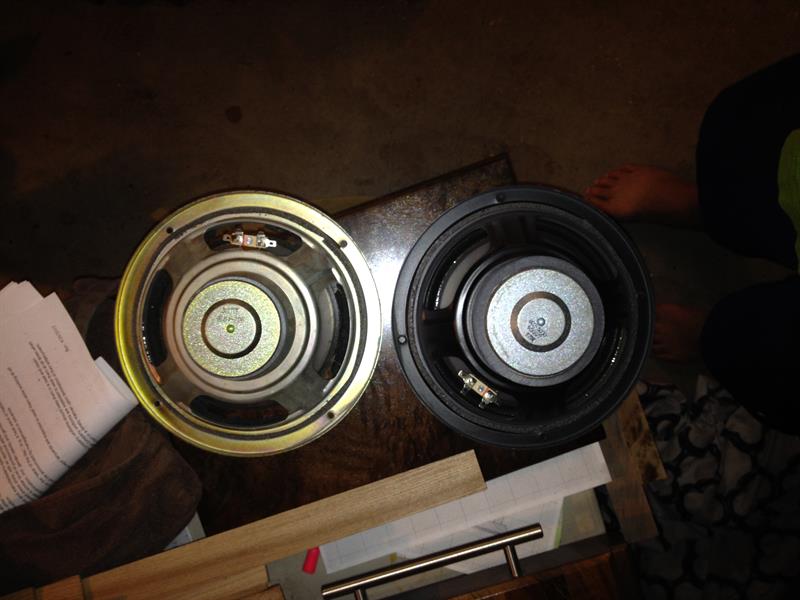

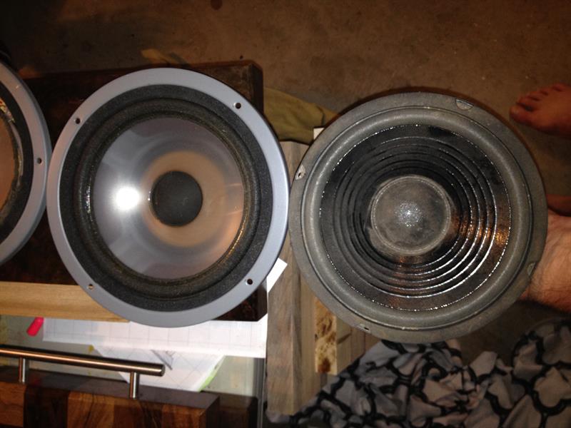

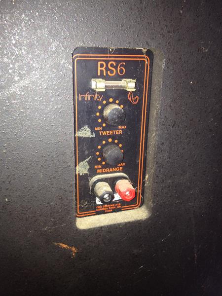

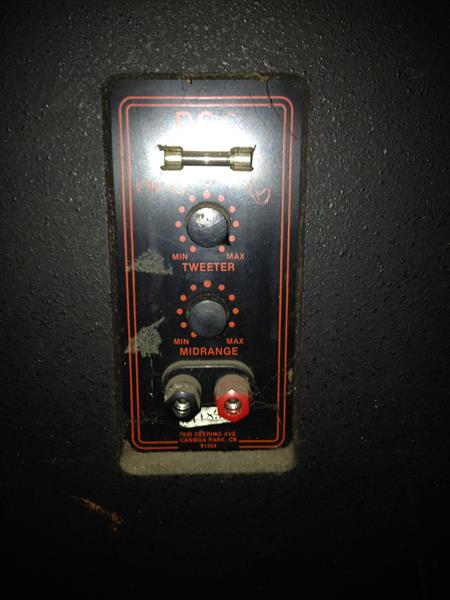

PMAT 2,084 Posted October 12, 2014 Author Posted October 12, 2014 Crapola, I thought a simple refoam would do. Noooooooo Waaaaaay. I pulled the drivers out of the free(!) 6's and low and behold the woofers are different. One is way wimpy. One is pretty nice. The one on the left is half the weight and cheaply built. So I find my 6B woofers and they are no clear, they are black. They are nicer like the one but smaller in diameter. so I investigated the crossovers and the 6 and 6b are different. OK, expected. The binding posts are clearly inferior on the 6b's Dammmmit! Ok so I hit the net to find the proper driver and thats not so easy. Crappola!
