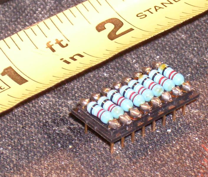

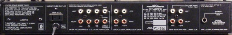

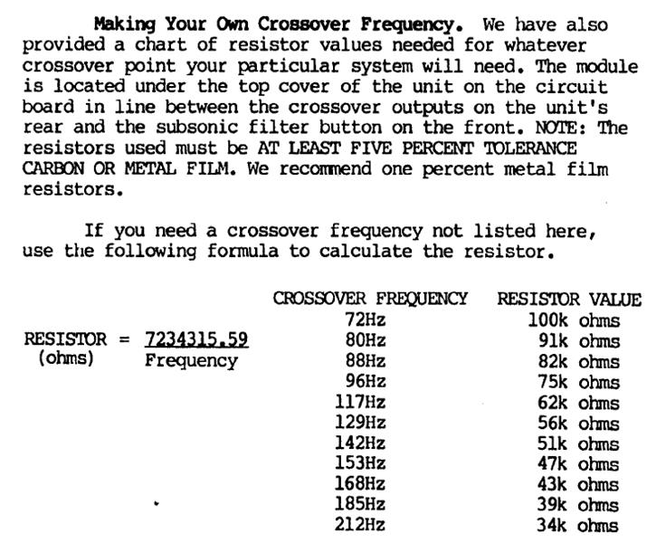

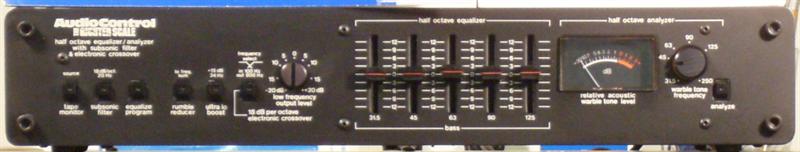

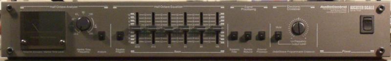

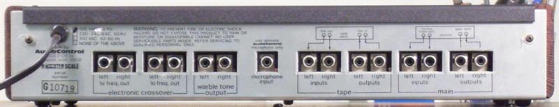

zumbini 6,154 Posted February 19, 2015 Posted February 19, 2015 If you are adding a subwoofer to a full range speaker an Audio Control Richter Scale is a good choice. They come up on ebay pretty regularly for $80-150 (original model) and $160-250 (Series III). The original offers 2 XO frequencies (100Hz or 600Hz), a 1/2 octave EQ and warble tone generator. (You'll need the original condensor mike, or equivalent, to take advantage of the built-in analyzer.) The Series III can be adjusted for any XO frequency using readily available plugin resistor modules. The unit I bought in the 70's came with 80 and 120Hz chips and a postcard you could send in to get a 3rd chip free. Most of the units I see on ebay don't mention the 2nd module but often it's taped to the PCB inside. (Again you'll need the original condensor mike, or equivalent, to take advantage of the built-in analyzer.) This is a crossover module (it's just a simple resistor network on a 16 pin DIP), and instructions for changing the crossover frequency: 3
