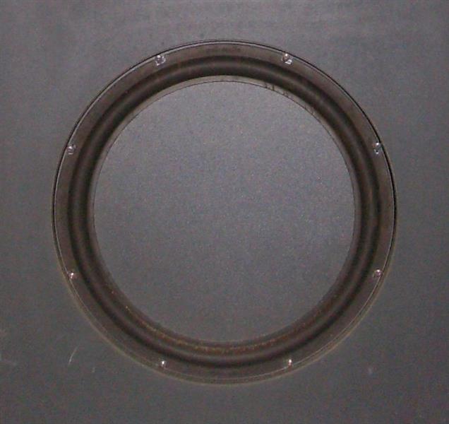

zumbini 6,147 Posted August 17, 2015 Author Posted August 17, 2015 No big deal David. I have plenty of time now that Zack is back at school, and lotsa help from the "experts". Today I finished repairing the mid woofer surrounds on the right speaker. I also inspected the passive radiators and found them to be in great shape. 1

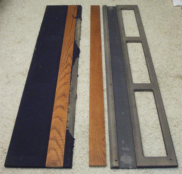

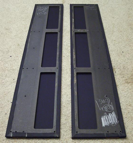

zumbini 6,147 Posted August 18, 2015 Author Posted August 18, 2015 Two steps forward, two steps back.... After giving the RTV on the right speaker 24 hours to cure I powered up for some critical listening. I used a y-adapter cable to twin the left channel preamp output and sent that to both amp channels. I heard an improvement in detail and transient response in the repaired right channel speaker. Then I listened to the output of each of the mids and tweeters using a 2" mailing tube to isolate them. Bad news. The middle tweeters (T2 and T3) on both speakers had zero output. I'll follow up today. I patched a few pinholes in the right speaker mid surrounds that I'd missed and recoated one of the large rips. Then I put a first coat of RTV on all the rips, tears and pinholes in the left speaker mid woofer surrounds. Finally I stripped down the left side panel for the right speaker with the intention of recovered them. More bad news. I wound up cracking the wood insert piece (veneered MDF) while trying to remove it. After I got it out I saw why. At the point where it cracked I found a huge blob of glue and extra nails. I glued it back together so the break doesn't show but I'll probably replace all of the inserts with solid oak. Today's project - Recoat with RTV (if needed); pull the 4 "dead" tweeters and check the voice coils and wiring.

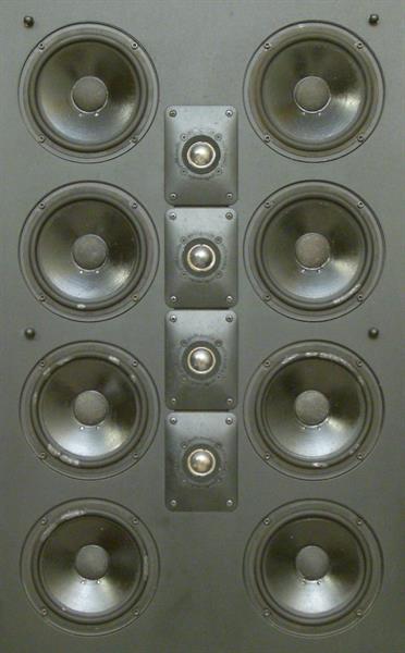

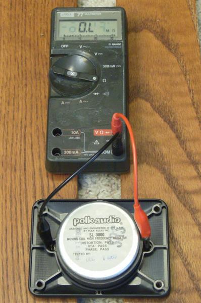

zumbini 6,147 Posted August 18, 2015 Author Posted August 18, 2015 I pulled out the non-working tweeters and compared voice coil resistance to one that works. The working tweeter reads 5.4 ohms; all of the non-working units read 0 ohms . Also checked the fine wires that connect the voice coils to the terminals. They look OK. Unless I'm missing something these results indicate that the voice coils are fried.....
Daddyjt 9,612 Posted August 18, 2015 Posted August 18, 2015 Dom, Are the middle 2 tweeters the "SDA" drivers? Are you using the interconnect cable? Would the SDA drivers operate on a summed mono signal? Just a couple thoughts...
Daddyjt 9,612 Posted August 18, 2015 Posted August 18, 2015 Dom, Check out this thread over at Polk for re-doming your tweeters... I would use the second dome they are talking about (the silk one), at about $11 a pair. I'm sure with your skills, this would be a breeze!

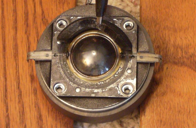

zumbini 6,147 Posted August 18, 2015 Author Posted August 18, 2015 Check out this thread over at Polk for re-doming your tweeters... I would use the second dome they are talking about (the silk one), at about $11 a pair. I'm sure with your skills, this would be a breeze! Interesting, but there are differences between the SL-2000 and my tweeters (SL-3000's). I will disassemble one of my non-working units further and see what it looks like inside.
Tronman 51 Posted August 18, 2015 Posted August 18, 2015 Zumbini, I'm sure you've figured out that the tweeter DOME will just pop off when you lift it by the terminals. On the back you will see the voice coil and where the wire has broken due to the years of movement/stress. I have a couple here at home that I am going to bring into work and look at them under a 40x microsope and repair them. The repairs can be done but you have to have a microscope a nice soldering iron and of course a steady hand. I repaired a few SL-2000 this way.
zumbini 6,147 Posted August 18, 2015 Author Posted August 18, 2015 Zumbini, I'm sure you've figured out that the tweeter DOME will just pop off when you lift it by the terminals. On the back you will see the voice coil and where the wire has broken due to the years of movement/stress. I have a couple here at home that I am going to bring into work and look at them under a 40x microsope and repair them. The repairs can be done but you have to have a microscope a nice soldering iron and of course a steady hand. I repaired a few SL-2000 this way. I haven't tried removing the voice coils yet so thanks for that tidbit Tronman. . I don't have a scope but I have several 10-20x linen testers that should do the trick.

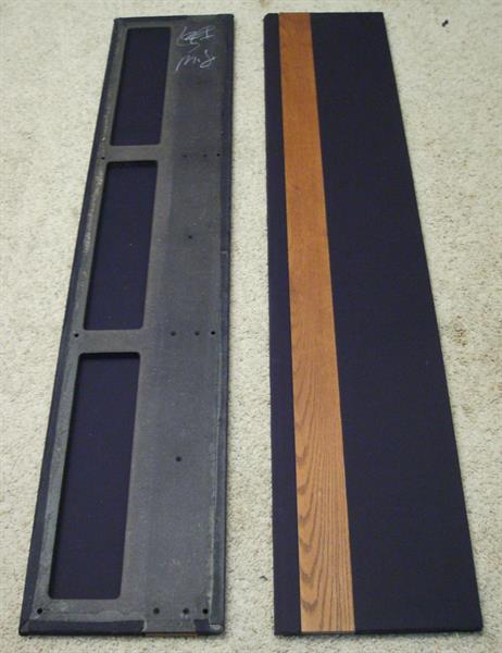

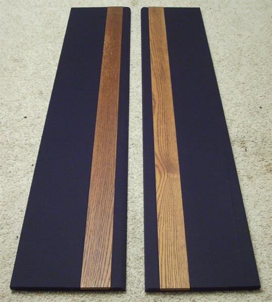

zumbini 6,147 Posted August 20, 2015 Author Posted August 20, 2015 Yesterday I recovered the side panels with the same material I used on the grill. There are a few "issues" that only I can see, but overall I'm happy with the result. before after recovering completed speaker 1
CT-Seven 764 Posted August 20, 2015 Posted August 20, 2015 Im in awe of the work Dom! Zack is going to be blown away 1
00cbirdw 195 Posted August 20, 2015 Posted August 20, 2015 Looking good Dom! Those grilles look SUPER clean.........if there's anything wrong with them you must be using that 'linen tester' to see it LOL!!!! 1
zumbini 6,147 Posted August 20, 2015 Author Posted August 20, 2015 Thanks guys. Most people (Zack included) won't notice the "defects" unless I pointed them out. But I'm more than a bit anal about my own work, and I know where all the bodies are buried....

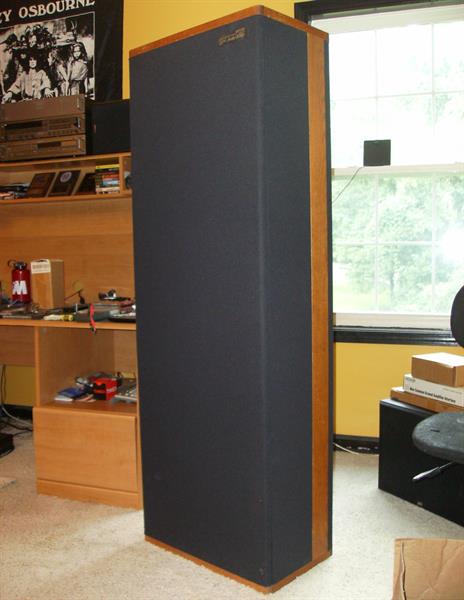

zumbini 6,147 Posted August 24, 2015 Author Posted August 24, 2015 Over the weekend I finished recovering the left speaker grill and side accent panels, I also filled in the scratches in some of the wood side panel inserts (from the cats I assume). I used screws to attach the inserts so I can easily replace them with solid oak at a later date. That completes the cosmetic restoration for now. Time to enjoy the music while I search for some tweeters! 2
