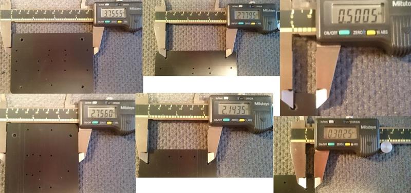

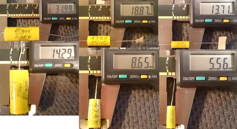

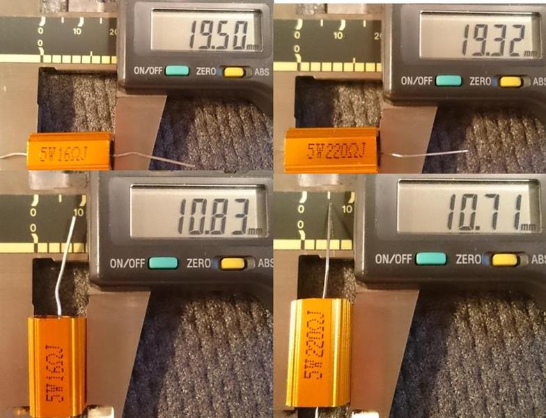

loner_t 2,572 Posted September 24, 2015 Posted September 24, 2015 Here is an absolutely awful drawing of how I wired a set. Can I get dimensions of the crossover plate and the resistors and capacitors and the inductance? I will try and put together an etched PCB drawing and get a quote from 4pcb.com. I can post the etched PCB layout once I have the drawing completed for review and feedback. 2
martin1970 361 Posted September 24, 2015 Posted September 24, 2015 Quote Can I get dimensions of the crossover plate and the resistors and capacitors and the inductance? I will try and put together an etched PCB drawing and get a quote from 4pcb.com. I can post the etched PCB layout once I have the drawing completed for review and feedback. Note: These dimensions are in inches 2

martin1970 361 Posted September 25, 2015 Posted September 25, 2015 Can I get dimensions of the crossover plate and the resistors and capacitors and the inductance? I will try and put together an etched PCB drawing and get a quote from 4pcb.com. I can post the etched PCB layout once I have the drawing completed for review and feedback. Note: These dimensions are metric 1

loner_t 2,572 Posted September 25, 2015 Posted September 25, 2015 Note: These dimensions are metric.. I assume both sets of pictures (this post and previous post) are in the metric. PS: Re-read the previous post. Thanks for clarifying.

martin1970 361 Posted September 25, 2015 Posted September 25, 2015 Note: These dimensions are metric.. I assume both sets of pictures (this post and previous post) are in the metric. PS: Re-read the previous post. Thanks for clarifying. Yeah, most of the plate dimensions looked like they were in inches. I'm assuming that all of the components resistors, caps, etc are in mm. Any idea what the lead time/cost would be for these boards?

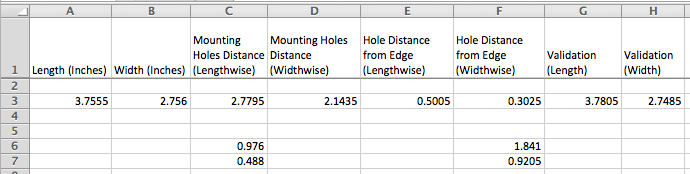

loner_t 2,572 Posted September 25, 2015 Posted September 25, 2015 @Martin.. please validate... Validation (Length) = G3. Excel formula is G3 = C3 + 2 x E3 Validation (Width) = H3. Excel formula is H3 = D3 + 2 x F3 If I do the reverse, then C6 = A3 - C3 C7 = C6 / 2 F6 = D3 - F3 F7 = F6 / 2 What am I doing incorrectly? Are the holes from edges asymmetric? Let me know if you need the spreadsheet.

BillWojo 542 Posted September 25, 2015 Posted September 25, 2015 LT, I would wait till you get your speaker set and measure the actual parts before commiting to buying pc boards. Measure the mounting points in side of the speaker housing, not the plastic bits. If they ship today, we should have them on Monday. BillWojo Just checked, it was picked up this morning from NC 1
