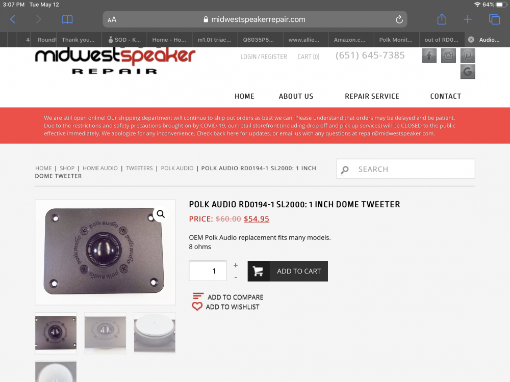

Daddyjt 9,648 Posted May 12, 2020 Posted May 12, 2020 These are the OEM Polk “upgrade” tweeters that belong in those speakers - the RDO-194. Polk has contracted Midwest to distribute the classic SDA drivers. https://www.midwestspeakerrepair.com/shop/home-audio/tweeters/polk-audio-1-tweeters/polk-audio-sl2000-1-inch-dome-tweeter/ 2 1
BarryG 2,853 Posted May 12, 2020 Posted May 12, 2020 (edited) Polk customer support would be cheaper if they have them in stock, there is an improved driver for the sl-2000 ( upgrade is rd0194) and for the dl3000 (Upgrade is rd0198). Last time I ordered , $49 each. Mention your a member of club Polk , get a small discount, thinking it’s free shipping! Midwest does not reduce price for club Polk members! The upgrades are with it! some 10’s may have sl-2500, if that is what was originally in there, use the rd0198! the first version of The 10s which I have, are fitted with peerless speakers! If I upgrade would be the rd0194! But have considered the rd0198 with changes to crossover! Various crossovers are on the forum https://forum.polk.com That Vifa driver might be an upgrade for newer speakers, I’m trying to figure how the box is sealed with that driver installed. The big woofer is passive, works well with a good sealed box! Edited May 12, 2020 by BarryG 3
