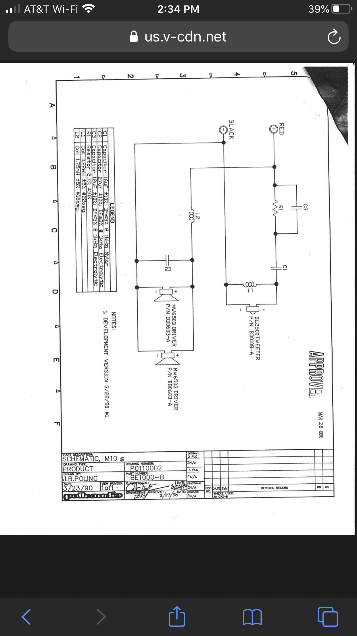

Rob 6,568 Posted May 15, 2020 Posted May 15, 2020 (edited) On 5/13/2020 at 11:49 AM, Sk1Bum said: I found this schematic, and it looks like the SL2500 is the original tweeter. That brings up a couple of questions. Should I decide to upgrade the crossovers, what parts should I use? Is a crossover upgrade something an absolute novice should attempt? Polk Series 2 Monitor 10 schematic.pdf 310.16 kB · 5 downloads Yes you can do it. I even tried it and I am a novice at heart. I heard that capacitors go bad over time so I decided to do this myself because a friend of mine told me it was cheaper to do yourself and an easy project. So I got all the values off the caps and resistors and made my own schematic of the crossover. I put in an order at parts express and got everything I needed then put it all together. They do sound a lot better than before and the tweeters work now. Good luck and just do it. If the tweeters are rated for the same freq why would you have to change the cap or resistor value? I found this awhile ago if it will help. Edited May 15, 2020 by Rob 4
BarryG 2,859 Posted May 15, 2020 Posted May 15, 2020 (edited) Use the values in the schematic, replace electrolyticS sand resistors! 12 uF electrolytic with polypropylene I used Dayton 27 uF electrolytic with polypropylene I used Dayton 2.7 ohm I used Mills! you don’t have to replace the 16 uF Mylar but it does not hurt! 3 or 4 components per speaker! Polypropylene caps are much larger than the electrolytic s! if you can’t find correct value, use two capacitors in parallel to get correct value! Edited May 15, 2020 by BarryG Correction 2
BarryG 2,859 Posted May 15, 2020 Posted May 15, 2020 The whole crossover is probably mounted to backside of the binding post plate!carefully mark , I used numbers and unsolder the wires mine had 4 wires! Since there are 4 wires and two colors, be careful! Now binding plate with crossover can be move to your workbench to work on. 2

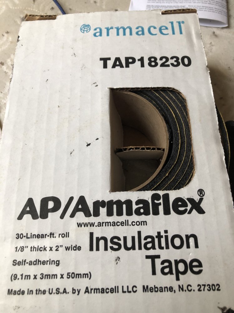

BarryG 2,859 Posted May 16, 2020 Posted May 16, 2020 (edited) 5 hours ago, CT-Seven said: One thing that would concern me is that the aftermarket tweeter added new holes into the cabinet and would have to be properly sealed before adding the new tweets (but maybe you are aware of this already) Seal as tight as possible, I’d check all gaskets, passive, mid woofers and even the connection cup! I bought a roll of armacell (tip from Polk forum). Trim as needed as it’s 2” wide, one roll will last for a lot of speakers! Edited May 16, 2020 by BarryG 2 1
