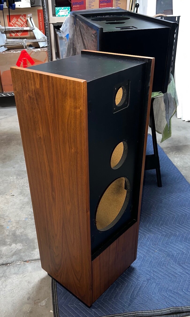

Zenith4me 1,576 Posted February 1, 2024 Posted February 1, 2024 Hello all, I’m working on a set of Infinity Column II speakers. So far, I’ve refinished the cases, refoamed the woofers, and rebuilt the crossovers. The speaker grills were MIA when I bought these speakers so I’m going to need to build new ones. Just so I don’t try to reinvent the wheel has anyone ever built speaker grills? If so, any advice would be appreciated. The original speakers used a primitive form of Velcro to mount the speaker grills and I’d like to update that method with rare earth magnets. I’m considering just a basic pine rectangle with a brace in the middle since the grills are fairly large. Anyway, you can’t have enough projects! 3

Zenith4me 1,576 Posted February 2, 2024 Author Posted February 2, 2024 22 hours ago, Kurt said: Have fun and post pictures! Here's some pictures. The case with the plastic sheeting on it is in the process of being painted. The other case has not been painted and you can see the faint outline of where the old Velcro style tabs were located. 5 1
stereo_dog 1,626 Posted February 2, 2024 Posted February 2, 2024 Looks good. Were those painted originally? 1
Zenith4me 1,576 Posted February 2, 2024 Author Posted February 2, 2024 2 minutes ago, stereo_dog said: Looks good. Were those painted originally? Yes, the front (where the speaker grill is attached), the top, and the back were painted. I refinished the sides as can be seen in the pics. I'm in the process of painting the one that you see with the plastic covering the part not to be painted. I bought these from a thrift shop and they were totally disassembled when I bought them. The speakers and crossovers were in a box next to the cases. No speaker grills. The cases had varnish on them. I was amazed at how nice the veneer was after removing the varnish. BTW....I hooked up the speakers to one of the rebuilt crossovers and they sound great. If I can ever get past my honey do list I'll be finishing these up.....lol. 4

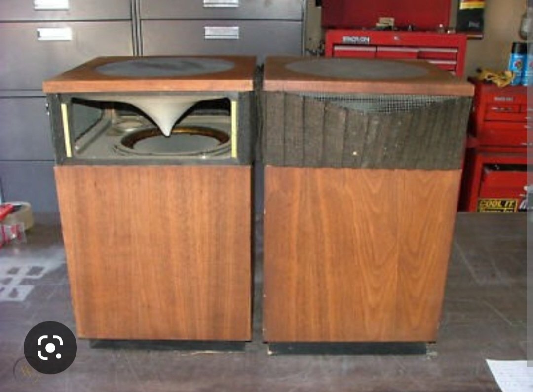

stereo_dog 1,626 Posted February 2, 2024 Posted February 2, 2024 They will look good. A nice score. I've got a set of Altec Valencias that I picked up a few years back. I've built new crossovers and they sound great, but the cabinets are terrible. The guy had them in his basement and let his dog pee on them... needless to say, they sat in my garage for a year before I brought them into the house. I need to rebuild the cabinets, but, they're huge and I don't have much space in the garage to work on them. Maybe this Spring. Enjoy the Infinitys. 1
Zenith4me 1,576 Posted February 2, 2024 Author Posted February 2, 2024 1 hour ago, stereo_dog said: Do you have the glass tops? No, I wish I did. I think that were tinted and thick glass. I've priced custom tinted glass cut to fit and let me just say it isn't cheap. I paid $75 for the speakers and the glass was ~$500. I'm thinking about alternatives such as plexiglass. 1
4krow 7,372 Posted February 2, 2024 Posted February 2, 2024 This went deeper than I had anticipated. You found these in unlikely place for an unlikely price. Glass tops may fall into your lap. Don't go out for quotes, go hunting instead. I am not that big into trying to find what I need just anywhere, but then sometimes I end up at this recycling type store with OMG results. You have done this much on a chance. Either local or some weird little place you wouldn't normally think of. 2
4krow 7,372 Posted February 2, 2024 Posted February 2, 2024 Looked on eBay for the hell of it. This may not be real glass, but I saw chip in it and then wondered if it might be. WTH is poly glass? Look at 1/4" Thick Tinted Rectangle Poly Glass Window It is for a boat. It costs $29+$9 for shipping. It is a pair. Sorry that I cannot be of help for links and crap like that.
Zenith4me 1,576 Posted February 2, 2024 Author Posted February 2, 2024 1 hour ago, 4krow said: This went deeper than I had anticipated. You found these in unlikely place for an unlikely price. Glass tops may fall into your lap. Don't go out for quotes, go hunting instead. I am not that big into trying to find what I need just anywhere, but then sometimes I end up at this recycling type store with OMG results. You have done this much on a chance. Either local or some weird little place you wouldn't normally think of. I'm in no big hurry to get glass for it. I saw a pair of these speakers in San Diego and they had cut a thick piece of wood to fit in that area and then a normally priced piece of standard glass on top of that. Where it starts getting expensive is when you buy bronzed glass with polished edges. 1

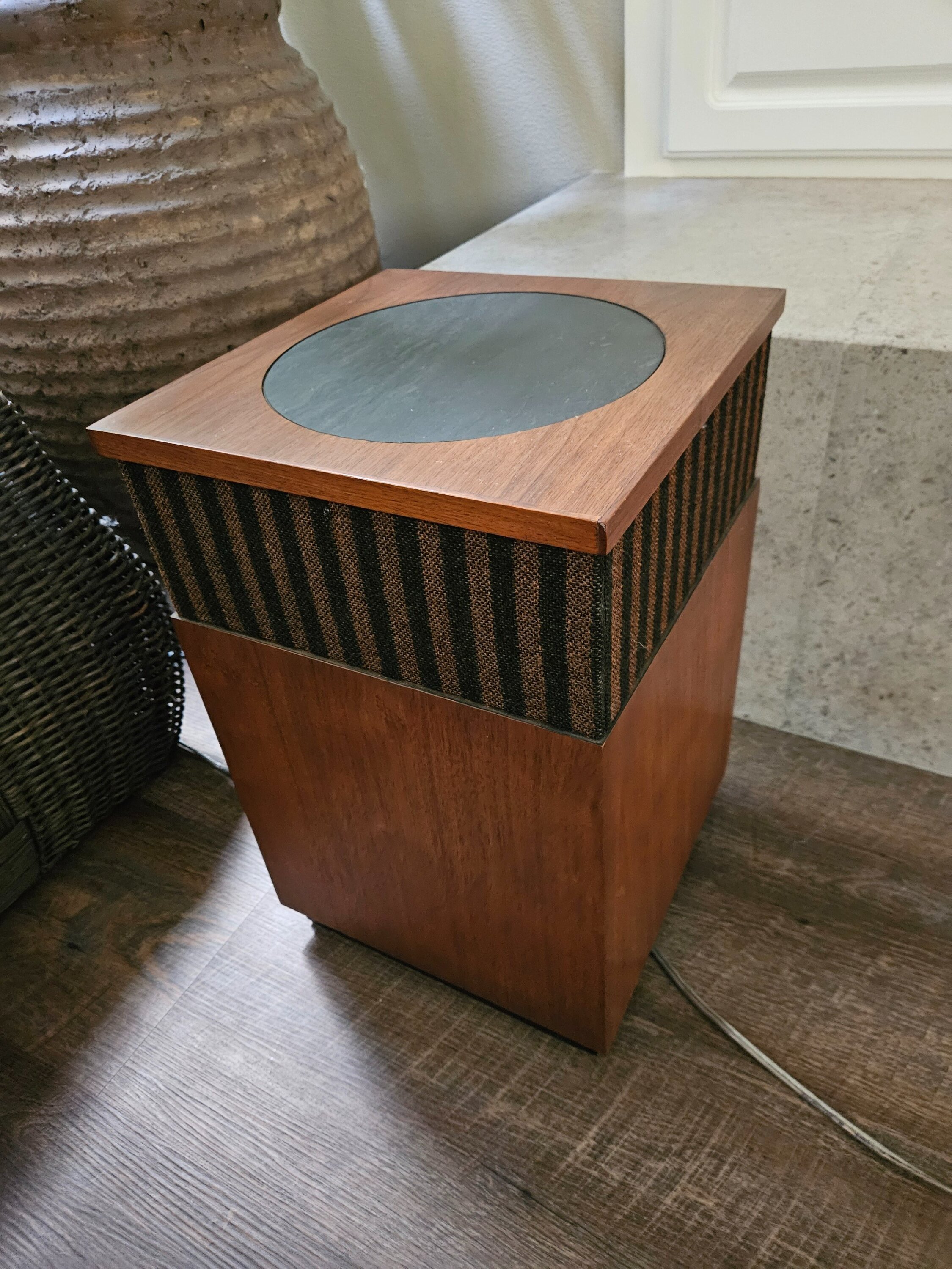

Receiver2000 4,626 Posted February 3, 2024 Posted February 3, 2024 I have these HK-50's with a stone top. I don't know what they were thinking - to set a drink or potted plant? Anyway, a piece of stone or porcelain might be options as well. 1 1
Zenith4me 1,576 Posted February 3, 2024 Author Posted February 3, 2024 Stone...that is wild. Lot's of options to consider. I'm not that big of a purist.
Receiver2000 4,626 Posted February 3, 2024 Posted February 3, 2024 This is the way the HK-50 is set up. Omnidirectional. 1 1
stereo_dog 1,626 Posted February 3, 2024 Posted February 3, 2024 3 hours ago, Zenith4me said: No, I wish I did. I think that were tinted and thick glass. I've priced custom tinted glass cut to fit and let me just say it isn't cheap. I paid $75 for the speakers and the glass was ~$500. I'm thinking about alternatives such as plexiglass. Try One Day Glass on the internet. I had some glass bases made for my Silver 9t's, (4) for around $185... I think. 3 1
Sk1Bum 12,997 Posted February 3, 2024 Posted February 3, 2024 Granite, slate, the right ceramic tile, corian... 2
