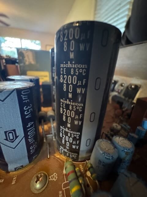

Benjaminsswanson 12 Posted December 20, 2025 Author Posted December 20, 2025 Thank you all for the warm welcomes and I apologize for the extended delay. The Carver began working again for a number of months. I opened up the Hafler DH-500 and could see one of the terminals (I do not remember if it was RCA in or Speaker out) had turned far enough for one of the posts to be touching another terminal or the case. It now has been working very well. Occasionally I will have to adjust the RCA in as a channel will cut out. Once I have some spare time, I will open it back up and see if I can tighten up the jacks or may need to replace them (any recommendations on replacement RCA terminals is welcomed). I was able to pick up a Hafler DH-110 preamp a couple of months back for a good price locally, so I have my Technics SL 1700 playing and picked up a second hand Apple Airport Express A1392 to use a decent streamer. I briefly opened up the Carver and will post a few photos. There are no signs of leaking caps but I do see one of the larger caps has some deformation on the top. I'm out of town for the holidays but will have to take look at the repair manual and get my multimeter out when I get home to check out Ryan's findings.
4krow 7,316 Posted December 20, 2025 Posted December 20, 2025 (edited) Those bulging caps look to be a warning shot to me. But if you go into this piece, it will benefit you to replace more than just these. Looks like someone already replaced the big caps, so that makes me wonder too. Now, it depends on what you are willing to do as far as the RCA jacks. Many of us here have replaced them something more sturdy. Personally, I use the RCA jacks from Manley Labs, but they can require enlarging the RCA jack holes to fit. Maybe not though. Anyway, it sounds like the jacks were already replaced, as they were able to be twisted? The jacks that Carver uses can't be twisted since they are connected directly to the circuit board. Properly tightened jack replacements won't easily twist either, but it sounds like yours weren't. Correction. I just viewed the photos, and it looks like these ARE original RCA jacks. What that means to me is that the jack lost connection right at the solder joint on the board, and that should inspected. If twisting the cable makes it work again, that is the problem. Edited December 20, 2025 by 4krow added info 1
Benjaminsswanson 12 Posted December 20, 2025 Author Posted December 20, 2025 3 hours ago, 4krow said: Those bulging caps look to be a warning shot to me. But if you go into this piece, it will benefit you to replace more than just these. Looks like someone already replaced the big caps, so that makes me wonder too. Now, it depends on what you are willing to do as far as the RCA jacks. Many of us here have replaced them something more sturdy. Personally, I use the RCA jacks from Manley Labs, but they can require enlarging the RCA jack holes to fit. Maybe not though. Anyway, it sounds like the jacks were already replaced, as they were able to be twisted? The jacks that Carver uses can't be twisted since they are connected directly to the circuit board. Properly tightened jack replacements won't easily twist either, but it sounds like yours weren't. Correction. I just viewed the photos, and it looks like these ARE original RCA jacks. What that means to me is that the jack lost connection right at the solder joint on the board, and that should inspected. If twisting the cable makes it work again, that is the problem. Sorry, the RCA issue is on the Hafler 500 amplifier. I was responding to a couple things. All the photos are of the Carver. I believe my dad got the Carver new and never had it in the shop, so I am pretty confident it is all original. The problem with the Carver is it going into protection mode after a few seconds (except when it doesn't and works fine for a few months).
