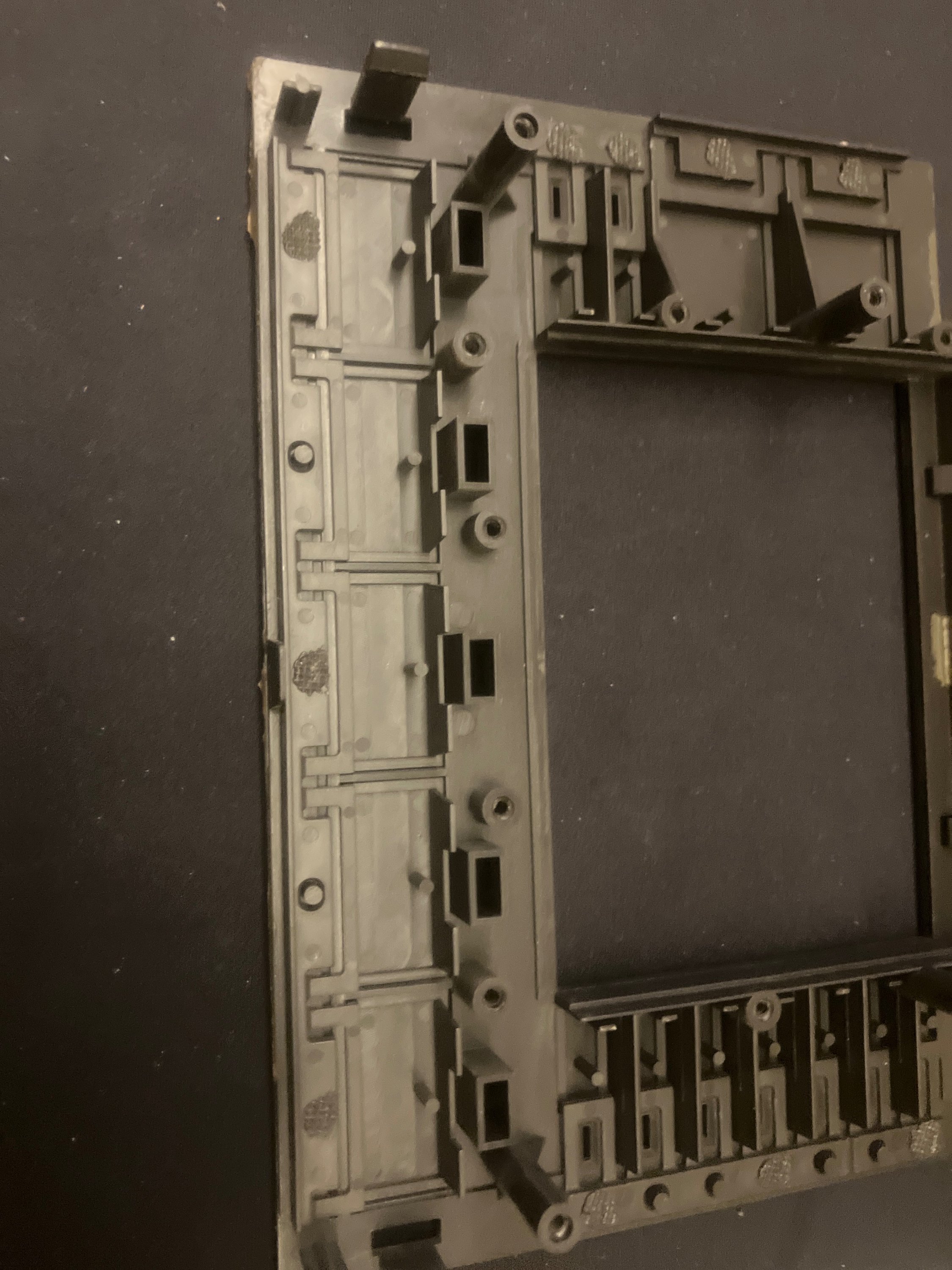

Technic1500 20 Posted July 13, 2024 Posted July 13, 2024 (edited) Well, I have an MXR-130 and I had to make on my 3D printer parts to put back into the Faceblock. Not a great picture as this system has size limitations. All the pushbuttons on the bottom were made by me. I also make the regular buttons for the controls. I made the buttons and had to re-engineer the parts holding them as they were broke too. The reason why you don’t see them out there is because it takes a lot of time to get them right, and they don’t sell. Edited July 13, 2024 by Technic1500 4 5

Rob 6,273 Posted January 1 Posted January 1 (edited) On 7/13/2024 at 9:11 AM, Technic1500 said: Well, I have an MXR-130 and I had to make on my 3D printer parts to put back into the Faceblock. Not a great picture as this system has size limitations. All the pushbuttons on the bottom were made by me. I also make the regular buttons for the controls. I made the buttons and had to re-engineer the parts holding them as they were broke too. The reason why you don’t see them out there is because it takes a lot of time to get them right, and they don’t sell. One of the reasons you don’t see the buttons out there is because nobody makes them. And if you can get a display frame, the plastic is old and fragile and will break easily if you don’t know what you’re doing. I’ve reconstructed many of these and used epoxy and other materials that work for the most part very well. Those buttons are separate pieces and the pins on the main piece get melted to the button assembly. It would be nice to have the whole display available and be a new production piece. Edited January 2 by Rob 1
Half Life 1,130 Posted January 1 Posted January 1 4 hours ago, Rob said: It would be nice to get things like these made. Hey Rob, Couldn't these be 3D printed say using ABS or PEEK? Color-matching would be the difficult part. I could definitely print one no problem. I'd have to locate a set of the button, model then and print. Hmmm, sounds like a nice winter project. BTW, I got into 3D printing (additive manufacturing) many, many years ago because of my pinball machine restoration hobby. Lots of those parts are no longer made. 2
Rob 6,273 Posted January 2 Posted January 2 4 hours ago, Half Life said: Hey Rob, Couldn't these be 3D printed say using ABS or PEEK? Color-matching would be the difficult part. I could definitely print one no problem. I'd have to locate a set of the button, model then and print. Hmmm, sounds like a nice winter project. BTW, I got into 3D printing (additive manufacturing) many, many years ago because of my pinball machine restoration hobby. Lots of those parts are no longer made. I don’t have any experience with 3d printing but it would be nice to get reproduction parts of the same quality. Im sure there are many levels and capabilities that 3D printers can achieve but the layered look? Can 3D printers create a piece that is a perfectly smooth surface? 1
