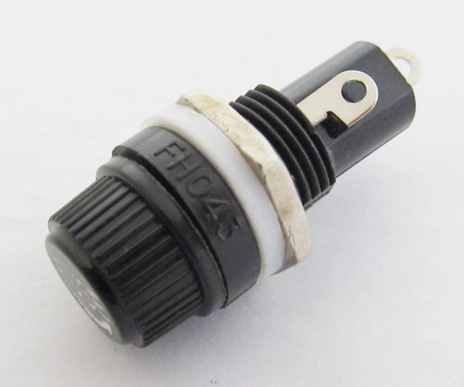

BobTFM35 3,309 Posted September 24, 2024 Posted September 24, 2024 I think the TFM 35 takes a TN032c which looks somewhat the same as the 55. Possibly on the barrel that is attached should be some part number markings to give a hint to the style. Something like the FH043 that's stamped on this holder. This is not what is on the 35 as I can't find a representative picture. 2

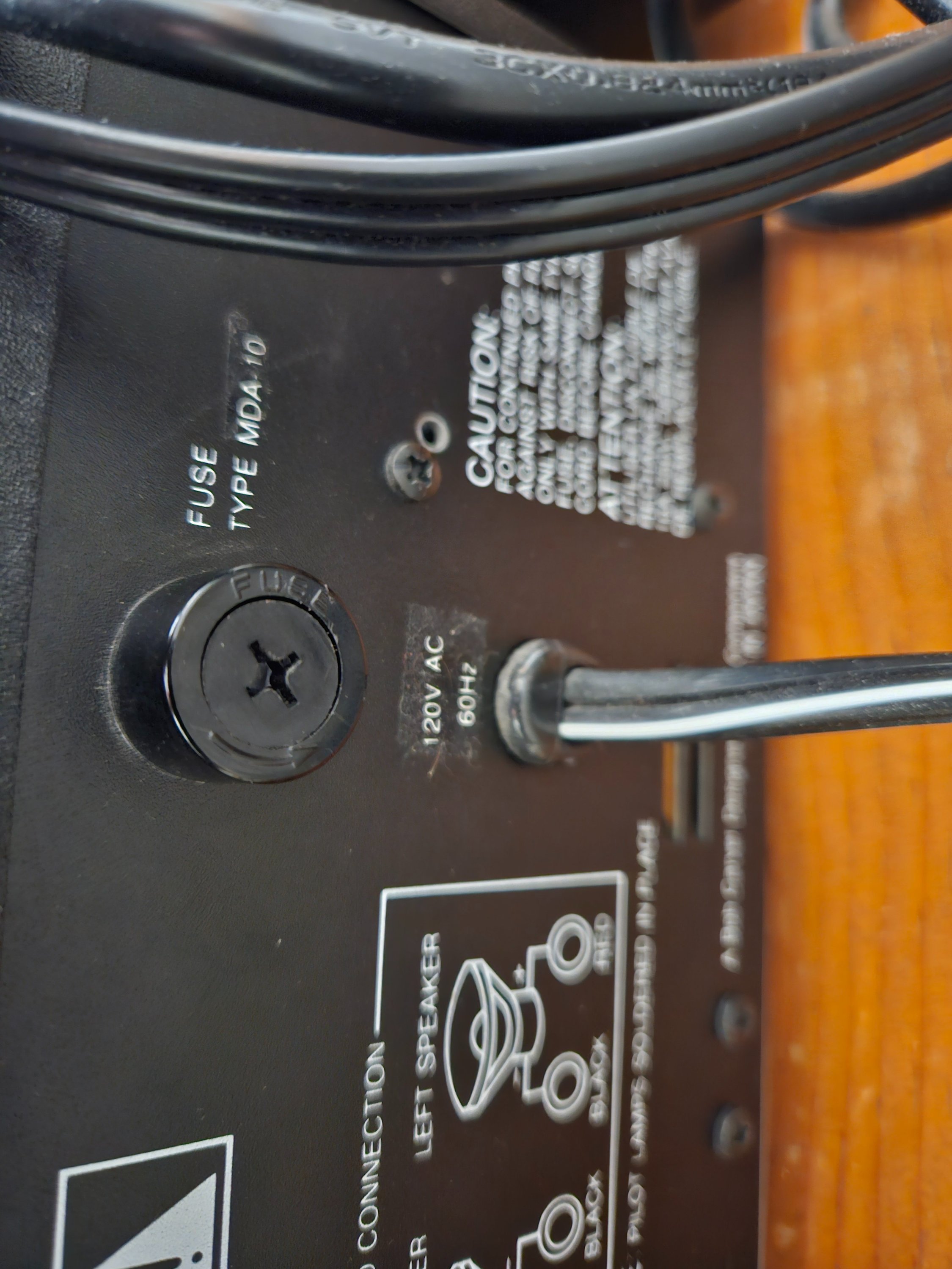

GDKZ 22 Posted September 25, 2024 Author Posted September 25, 2024 Here is an image of the missing fuse holder/cap from the TFM-55x. From my searches I assume there isn't any stock readily available for such items, just parted off other units??? Thanks! 1 1
BobTFM35 3,309 Posted September 25, 2024 Posted September 25, 2024 Thanks for that shot. Do you happen to have one of the inside portion of the holder. I think we might be talking about this type of fuse holder so compare this to yours. My thinking is that the gray portion might be a direct fit into your holder. https://www.ebay.com/itm/151152195191? 1
BobTFM35 3,309 Posted September 25, 2024 Posted September 25, 2024 My basis is from a Bussmann technical data sheet. Disregard the model number shown what is of interest is downloading the documentation lower down on the page. From the documentation I'm thinking and going with a guess, its a HTB-3 or 9x. But I somewhat feel that the gray part is common to possibly both. Only someone with a 55x can confirm this. The link for the document is on the left side below the picture. https://www.tme.com/us/en-us/details/bk-htb-92i-r/panel-mount-fuseholders/eaton-bussmann/ 1
GDKZ 22 Posted September 25, 2024 Author Posted September 25, 2024 Ok, just removed the case and here is the image of the back of the fuse holder. 3
BobTFM35 3,309 Posted September 25, 2024 Posted September 25, 2024 I think I am close knowing, but without a part number to help confirm, it would be a shot to get it correct. Need to know if its a 1/4" x 1-1/4", or 5mm x 20mm fuse that fits in the existing body that is shown. I'm hoping that someone comes along that can better help with this. 1

Community Admin AndrewJohn 11,503 Posted September 25, 2024 Community Admin Posted September 25, 2024 Welcome, @GDKZ, so glad you found us. And you have found the right place. On your fuse issue..., the sad/bad news is that it is unlikely to find a replacement cap for an existing fuse holder..., the manufacturers have variations beyond belief..., I know..., I've had that issue before - and replaced the whole unit (internal and cap) in every case. The caps from one maker to the next, don't cross-fit, and even from one maker's production run to another run..., they don't fit. I've even seen different housings/caps on the same model of Carver amps, so the cap from one amp model x, won't fit another same model x amp. They are easy to replace..., easy solder job - just take your time. Again, glad you found us! Lots to learn here. Start a thread on your repair! include lots of pictures..., we love pictures. 1 3
