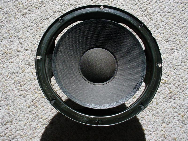

Circuits & Concepts 330 Posted December 30, 2011 Posted December 30, 2011 I started re-foaming my Advent speakers over the Holiday break with assistance of my daughter, Emily. I enlisted her assistance, as she is listens to them most regularly. We got the baskets and cones cleaned off. The next step in the directions says REMOVE THE DUST CAPS. I understand that aligning the voice coil is very important. My question for Kevin (or anyone else who wants to chime in) is whether the voice coil can be aligned without hacking into the dust cap. Thanks in advance for your help! Les

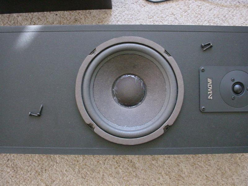

Circuits & Concepts 330 Posted December 30, 2011 Author Posted December 30, 2011 I experimented with using coil movement to center the coil, but I went with cutting the dust cover 7/8 of the way around and shimming the coil. I used 24 lb paper strips for the shims. Using Kevin's recommended 3M Plastic and Emblem Adhesive, which cures very quickly, everything is done! All that remains is to screw the drivers in and clean up the glue on the dust caps. I'll let the speakers set with the cones pointed up as long as my patience will allow (maybe until this evening), then see how they sound. Thanks to all for your advice! Cheers! Les
