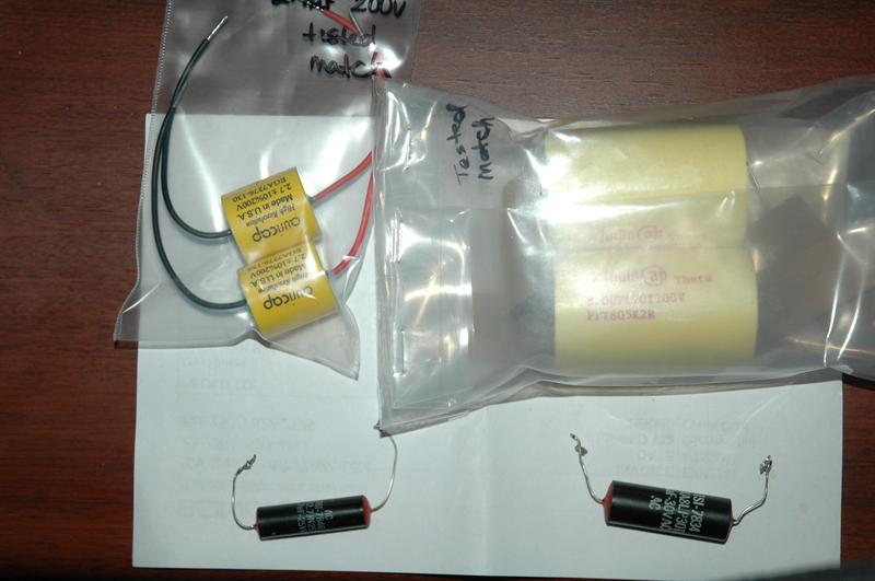

danowood 2,167 Posted June 25, 2013 Author Posted June 25, 2013 Decission finally made, after recomendations from an engineer from Sonicraft I have decided to go with the Auri cpas for the tweeters and the AudioCap theta's for the mids on the crossovers. The Auri's were about 18.00 a pop each and the Thetas were 48.00 a pop each. I also paid a couple extra bucks each for Level 2 matching within .5% of each other. Last phase is to recap these puppies and install new gold plated bannana plugs on the cups and put these things back together and then out the door. Will include final pics when done with them. 1

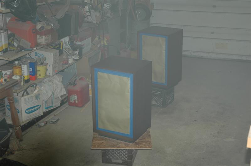

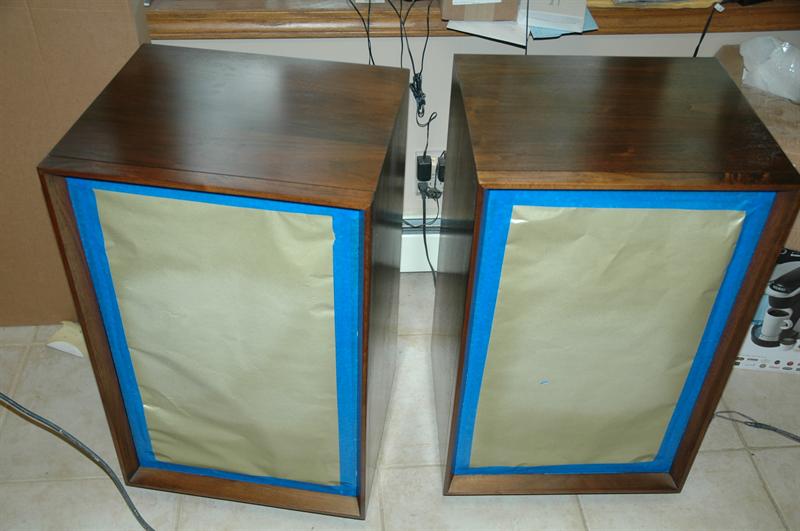

Gene C 1,753 Posted June 25, 2013 Posted June 25, 2013 Nice job Dano. Did you just spray the cabinets with urethane coating? 1
danowood 2,167 Posted June 25, 2013 Author Posted June 25, 2013 sherwin williams medium Rub Lacquer. Thats mostly what I use. I haven't lightly steel wooled them down yet and then appied wax. The pic of the speakers in the garage is from the fog of lacquer spray, but it doesn't affect the finish much. It's a low sheen lacquer finish. It's shinnier than it would normaly be, but I shot about 7 or 8 coats, steel wooling them down between coats. I'll either brown bag rub them down or use steel wool lightly rubbing them down to dull the shine a little more then wax them down. Thanks for your back slap. Hi five!!

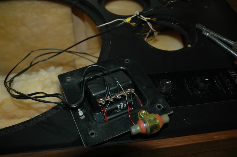

danowood 2,167 Posted June 28, 2013 Author Posted June 28, 2013 Just received the capacitors today. I could tell just by the weight of the package that these weren't no ordinary capacitors. Probably over kill, but impressive all the same. Look at the difference from the Jensen capacitors that were in it compared to the replacement ones. On the left are the 2.7uf and on the right are the 8.0's. Dang, going to have to make up something different as the Jensen capacitors were tucked under the connecting board on the back of the cup. There is no way these are going to fit on the cup, without some ingenuity, and probably will need to attach a piece of Plexiglas to the back of the cup to mount the capacitors. Any ideas?
Retriever 1,145 Posted June 28, 2013 Posted June 28, 2013 Holy size increase! I haven't shopped capacitors in a while are those polypropylene caps? Voltage rating must be high enough for a tesla coil!
danowood 2,167 Posted June 28, 2013 Author Posted June 28, 2013 I couldn't attest to material used but am sure it's a film capacitor, but it must be some trade secret as to what they use for dielectrics, tantalum, silver mica, snot? My guess is probably double layered. Don't know. They seem to be snobbishly into high end only. http://soniccraft.com/ In further research (the Capacitor has PET #####) PET stands for Polyester. Another article has a lot of info on it in regards to the types: http://en.wikipedia.org/wiki/Types_of_capacitor#Film_capacitors
