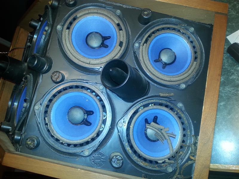

fill35U 1,848 Posted October 30, 2014 Posted October 30, 2014 Thanks for posting pics, Brian! 18 drivers to refoam- your task lies ahead of you! BTW, the Series III and IV were most susceptible to foam rot. V's and VI's are much more resistant. And of course I's and II's used cloth surrounds. 1

srinath 34 Posted October 30, 2014 Posted October 30, 2014 Thanks for posting pics, Brian! 18 drivers to refoam- your task lies ahead of you! BTW, the Series III and IV were most susceptible to foam rot. V's and VI's are much more resistant. And of course I's and II's used cloth surrounds. 5's rot. In fact some early 6 I have heard also rot. They used to trade a rotted out 4, 5 or 6 in the first many years of the improved 6 - like pre 87 or 88 6's used to rot too. But sometime in the 90's Bose would swap your 4/5/6 with bad foam for new 6's. Someone who I sold my 6's to told me he swapped a 4 for a 6 in the mid 90's. Cool. Srinath. 2

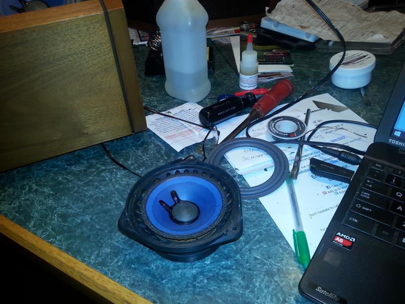

pindrop 330 Posted October 31, 2014 Posted October 31, 2014 Hey Brian when you're getting the drivers ready to put the new surround on, are you supposed to remove the rotted surround and all the old glue or what? I've never done it before but was thinking the old glue would need to come off before applying new glue.
