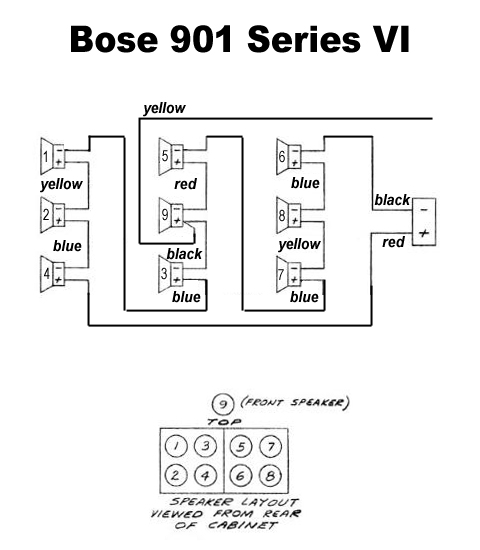

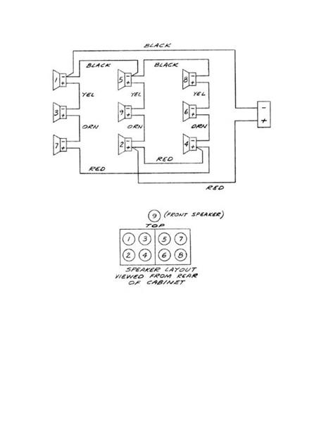

nascar03 25 Posted October 31, 2014 Posted October 31, 2014 I just need to make sure which ever bose901 driver I buy is 1 ohm .. --Another question- Is the front driver the same as the rear 8 drivers?? Hi Brian... I have a set of BOSE901 series II. I'm assuming the newer versions follow the same build parameters although with newer drivers and equalizers. I believe the Bose901 drivers are 6-8 ohms each and thru use of proper series/parallel circuit wiring will ultimately show a 6-8 ohm total load to the amplifier. They are not 1 ohm each. Be sure to follow the internal wiring connections within each cabinet. The front driver is the same as the other drivers in the cabinet. I don't envy you having to do 18 foam surrounds... Good on you. Graham 2
fill35U 1,848 Posted October 31, 2014 Posted October 31, 2014 I just need to make sure which ever bose901 driver I buy is 1 ohm .. --Another question- Is the front driver the same as the rear 8 drivers?? Hi Brian... I have a set of BOSE901 series II. I'm assuming the newer versions follow the same build parameters although with newer drivers and equalizers. I believe the Bose901 drivers are 6-8 ohms each and thru use of proper series/parallel circuit wiring will ultimately show a 6-8 ohm total load to the amplifier. They are not 1 ohm each. Be sure to follow the internal wiring connections within each cabinet. Series I & II used 8 ohm drivers, wired as three parallel strings of three drivers in series each: The drivers in Series III through VI are nine 0R9 drivers in series: 3
nascar03 25 Posted November 1, 2014 Posted November 1, 2014 I'll be darned! Thanx for posting the diagrams. I wonder where the yellow wire goes? Graham

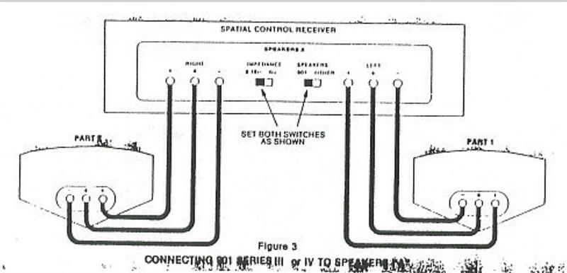

fill35U 1,848 Posted November 1, 2014 Posted November 1, 2014 I'll be darned! Thanx for posting the diagrams.I wonder where the yellow wire goes? You're welcome! The yellow wire doesn't exist for the Series V & VI, despite the drawing's title. The Series III & IV bring the yellow wire out to a third terminal. This was intended to be used with the Bose Spatial Control Receiver: This stereo receiver actual had *four* channels. Not only did it incorporate EQ for the 901's, it allowed the user to adjust the signal sent to the inner drivers of each 901. Probably mixed in/out the mid & high components of the L-R difference signal?: FWIW, the 601 Series II, which had inner and outer sets of drivers, also had the third terminal. 1
srinath 34 Posted November 1, 2014 Posted November 1, 2014 [ FWIW, the 601 Series II, which had inner and outer sets of drivers, also had the third terminal. This is the truest picture of sound from a 901. It will go all over the place and hit your ear like soup. Some kinda weak and bland soup. You'd be temped to look under the speaker in case there is some kind of beaver or badger eating up all the good parts of the soup. In all honesty though, if your room was this geometric, and you have no stupid furniture in the way, and no drapes, no curtains no cabinets and had perfect symmetry, it may sound OK. I had much better sound keeping pointy side toward you. Both on the 1/2 and the 6's. Cool. Srinath.
srinath 34 Posted November 1, 2014 Posted November 1, 2014 I have a series 2. No third wire in mine. Maybe the 2 continental had it ? Cool. Srinath.
