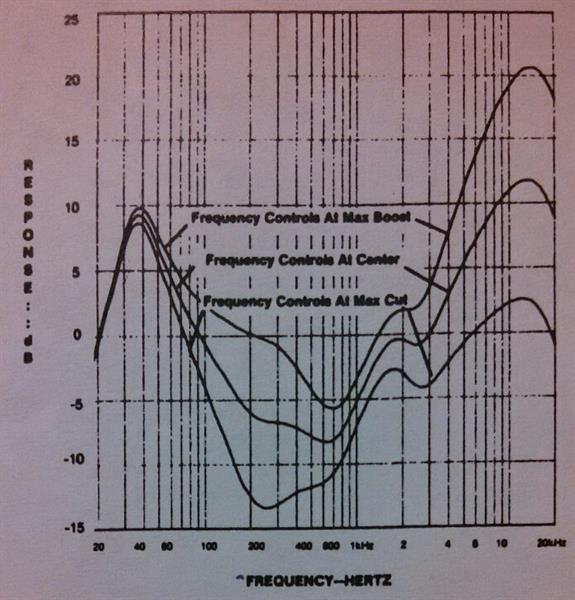

fill35U 1,850 Posted November 5, 2014 Posted November 5, 2014 Congrats on getting them up and running! I don't think you'll hurt them by driving them harder, at least with unclipped music signals. Don't forget that EQ is cutting out a lot of the mids, and boosting the snot out of the highs and lows! They would probably sound a *lot* louder without the EQ. Here's a chart you can't find on the Internet. EQ curve for a Series VI: I won't argue that the IV's have a *different* EQ, I know the V's are definitely *slightly* different. But given the similarity of the drivers, III's and IV's should be *pretty much* the same. In any event, look what the user-adjustable controls can do to the response. In theory, those controls are there to help you compensate for the room (presumably floor bounce and wall reflectivity). I don't think the EQ would clip at the input buffer from too high a level- its got +/-15 V supplies. But with 15dB of boost at the first stage, I could see it clipping "along the way". And with better than 20dB of boost available overall, it won't take much at 15kHz to cause problems! 1

fill35U 1,850 Posted August 28, 2016 Posted August 28, 2016 IMHO you'll be fine with the later drivers. Due to the nature of the beast, I'd put your best two drivers in the fronts. In practice, I don't think you'd notice much difference swapping drivers or EQ between Series III-VI. There is actually a big difference between the III and VI EQ's. I had both back in the day. Previously posted Series VI EQ curve: From the Spatial Control Receiver service manual: So Series III and IV have identical EQ. Compare the Series IV and Series VI (middle curve) EQ's above. About 3dB difference at the 35Hz and 14kHz peaks, definitely significant. But less so in view of the adjustability of the controls. 2
