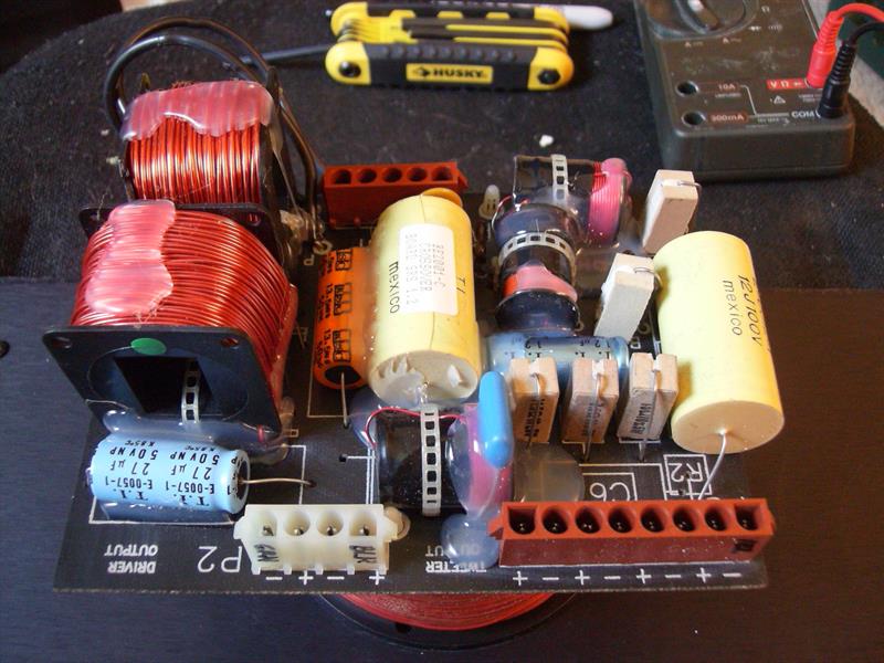

Tronman 51 Posted August 25, 2015 Posted August 25, 2015 Zumbini, "At this point I think I'll keep looking for some SL3000's and save up for the Polk replacement (RDO198-1)" Before you order don't forget to log into the Polk Forum so when you order them they will give you free shipping http://forum.polkaudio.com/ http://forum.polkaudio.com/discussion/55888/polk-audio-speaker-wiring-schematics-more-stereo-dimensional-array-sda You really should head over to Polk Forum and post any questions if you have them - those guys have great information as they have already been there and done that especially with the SDA SRS 1.2tl. To give you an idea here is one of the modified crossovers by VR3 Mods, he goes a little over the top but this just gives you an idea of what these guys are willing to do as an example: http://www.ebay.com/itm/Polk-Audio-SDA-SRS-1-2-1-2TL-Vr3-Mods-The-Abbot-Crossover-Modification-EACH-/151626235874?hash=item234da0bfe2 Those are looking really good by the way, not sure if you have the little metal feet on the bottom but ACE Hardware sells some that work perfect, let me know as I have to pick up another pair and I have the box if you need the info off of it.

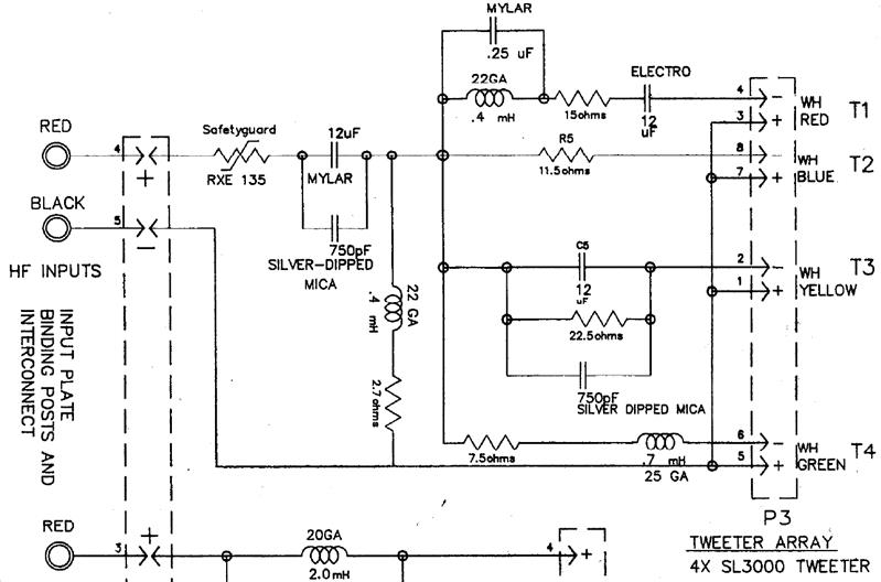

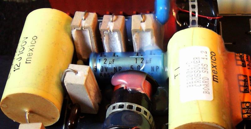

zumbini 6,150 Posted August 27, 2015 Author Posted August 27, 2015 I was able to trade the A1-I SDA Non-Common Ground Interface for 4 used SL3000 tweeters. While waiting for them to arrive I figured it would be smart to determine why the originals failed. (I don't want to install the new tweeters and fry them due to an issue with the wiring or crossovers.) So I pulled the crossovers for a visual inspection and found no bad solder joints or bulging/leaky caps. I did find white powdery deposits on some of the block resistors. Is this "normal" or indicative of a problem? I also measured the resitance of the crossover circuits with the tweeters removed: T2: left = 14.0 ohms; right = 14.2 ohms T3: left = started around 6 megaohms; right = started around 8 megaohms (Both readings increased slowly over time, I assume the battery in my meter was charging the cap?) Do these measurements make sense based on this schematic or do they indicate a problem?
Tronman 51 Posted August 28, 2015 Posted August 28, 2015 zumbini, You wrote: "While waiting for them to arrive I figured it would be smart to determine why the originals failed" Just some FYI on the tweeters, you had me thinking about the non-working tweeters I pulled from my SDS SRS 1.2tl's and so far the 3 I have looked at have had the following issues: (2) Open wire where it goes into the dome (1) Intermittent open where it goes into the dome Used 30 gauge wire to repair the damaged wires. 40X microsope and a nice soldering iron I will be looking at the rest of them tomorrow but my point is most of the time it is just age which do these in. Try putting a multi-meter on the connectors + and - and gently push on the dome where both wires go into the dome and see if you get continuity or at least something registering on the meter - best to take them apart and remove that sticky foam they have on the outside around the tweeter dome and then do your test. The other check is to just look at the voice coil my bet is that all of the voice coils look good which would indicate a broken wire. For this "T2: left = 14.0 ohms; right = 14.2 ohms" - this looks correct 11.5 Ohms + 2.7 Ohms = 14.2 Ohms T3 I would think should be 25.2 Ohm unless I am missing something - 22.5 Ohms + 2.7 Ohms = 25.2 Ohms ?? The white stuff on the resistor is normal - as long as they read the correct resistance your good and those do not go bad very often - I have never seen one go bad anyway but that doesn't mean it can't happen. I would think it is going to be a little more difficult to detect a bad cap as what normally happens is that the caps get dried out and change value due to their age. Someone else like to chime in on this one? 2
zumbini 6,150 Posted August 28, 2015 Author Posted August 28, 2015 I put my DMM across the tweeter terminals. They all read open and pushing on the leads has no effect. The block resistors measure per the schematic (within the listed 10% tolerance). I haven't measured the caps as hot melt glue blocks access to most of the leads. (If I recall correctly one needs to lift one of the legs in order to read them.) The megaohm circuit resistance readings for T3 bother me. Can someone explain what might cause that?
B-Man 4,781 Posted August 28, 2015 Posted August 28, 2015 Looking at the schematic, I would say it is likely your crossovers are either different than the schematic circuit depicted or the trace / circuit path going to the 22.5 Ω resistor is open. 2
zumbini 6,150 Posted August 28, 2015 Author Posted August 28, 2015 Looking at the schematic, I would say it is likely your crossovers are either different than the schematic circuit depicted or the trace / circuit path going to the 22.5 Ω resistor is open.Thanks Brian. My research indicates that the crossover didn't change post-release, but I'll check it against the schematic later today. I'll also try to map out the T3 circuit on the board, ring it out, and test the 2 caps.

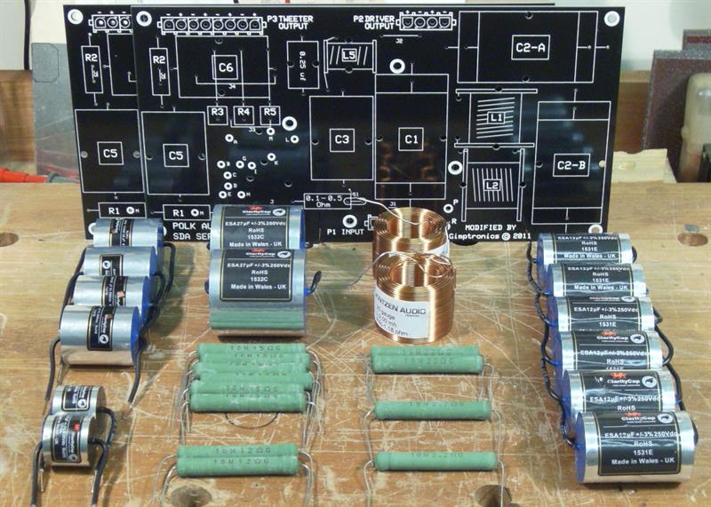

zumbini 6,150 Posted December 18, 2015 Author Posted December 18, 2015 Apparently the Carver Site isn't the only place where awesomeness occurs on a regular basis. I recently received a Christmas Karma for Zack from a group of mostly anonymous PolkAudio members. (I only know that Toolfan66 was involved because he messaged me to ask for my shipping address.) The generous gift includes a full set of "Larry's Rings" (mounting brackets for bolting in the drivers): Also Gimpod boards, ClarityCaps, Jantzen coils and higher tolerance 10 watt MOx resistors to upgrade the XOs: Zack doesn't know yet. I'll probably tell/show him tomorrow night after I pick him up at the airport. Hopefully he'll have time to help me install some of the upgrades while he's home for winter break. 6
