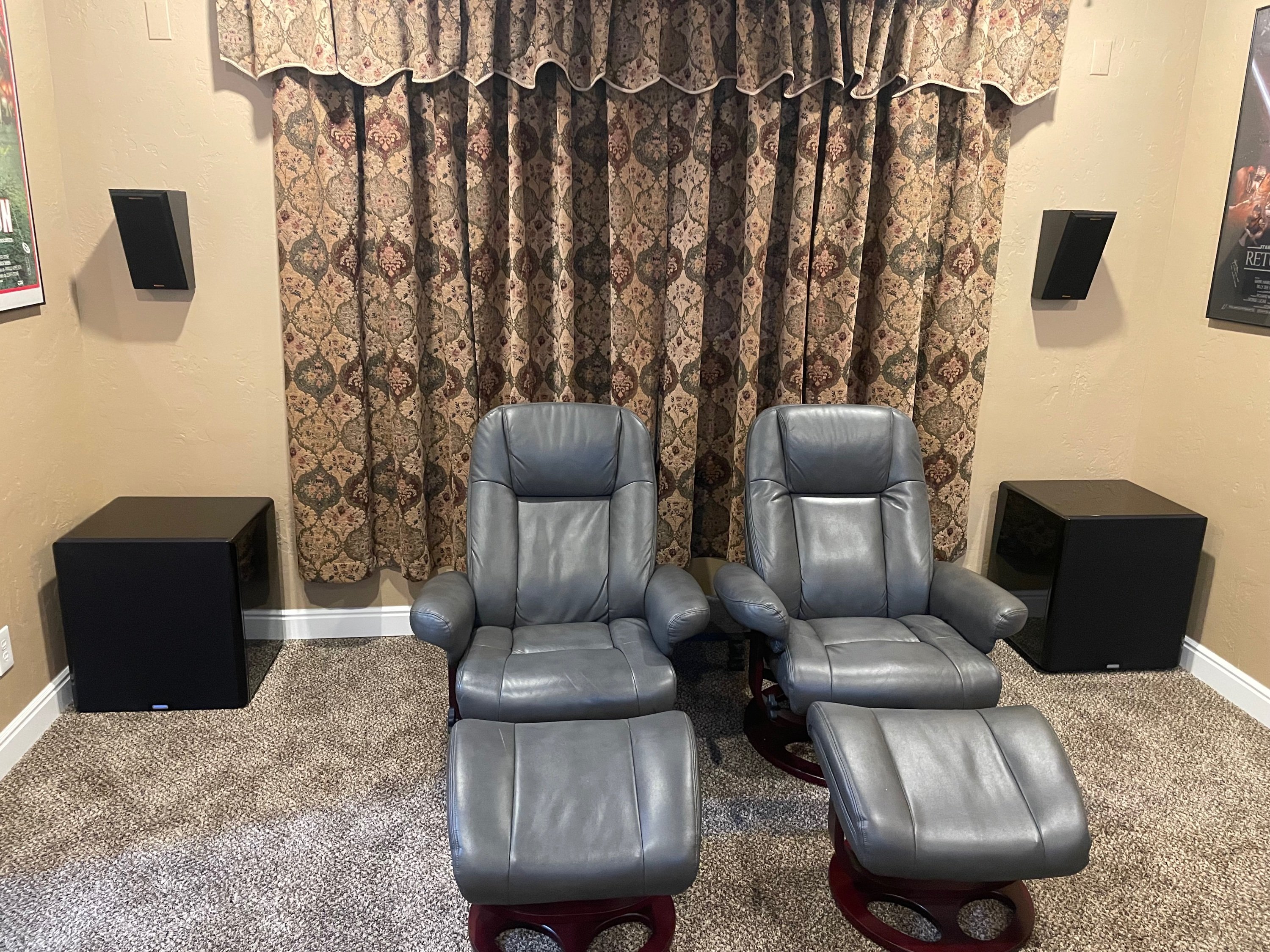

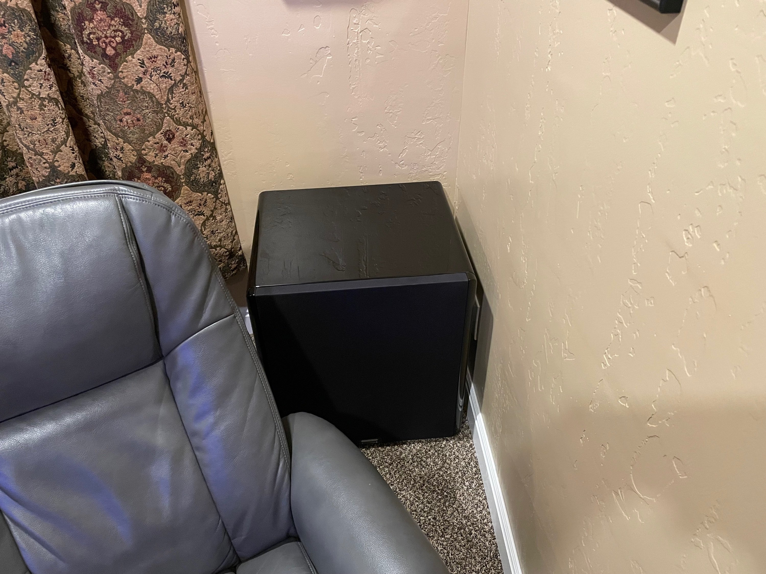

The rebuild of my HT after the flood of 2023 was just recently completed a couple months ago.  As I was rebuilding it anyway, I decided it was a good time to transition to a 4K Atmos 7.2.4 setup, from my previous 1080p 7.1 setup.  As part of this change, virtually all of my components changed - in fact, only my trusty Oppo 105D made the cut to the new system (playing FLAC and DVDA, which the 4k Atmos Panasonic won’t play).
I also pulled the Velodyne DD18, and added 2x SVS SB4000 subs.  This is where the headaches started.
Headache #1 - In order to get the Marantz SR6015 receiver to apply the Audyssey calibration to the subs correctly, the main speakers must be set to “small” - even though my RF7 mains are more than capable of playing down to 40hz.
Headache #2 - Integrating two subs is a royal PITA.  do you tune them together or separate?  Do you make adjustments in the Marantz, or in the EQ suite of each sub via the mobile App?
Headache #3 - what frequencies do you boost for the “punch” of movies, and then how do you restore some sense of fidelity for music listening?

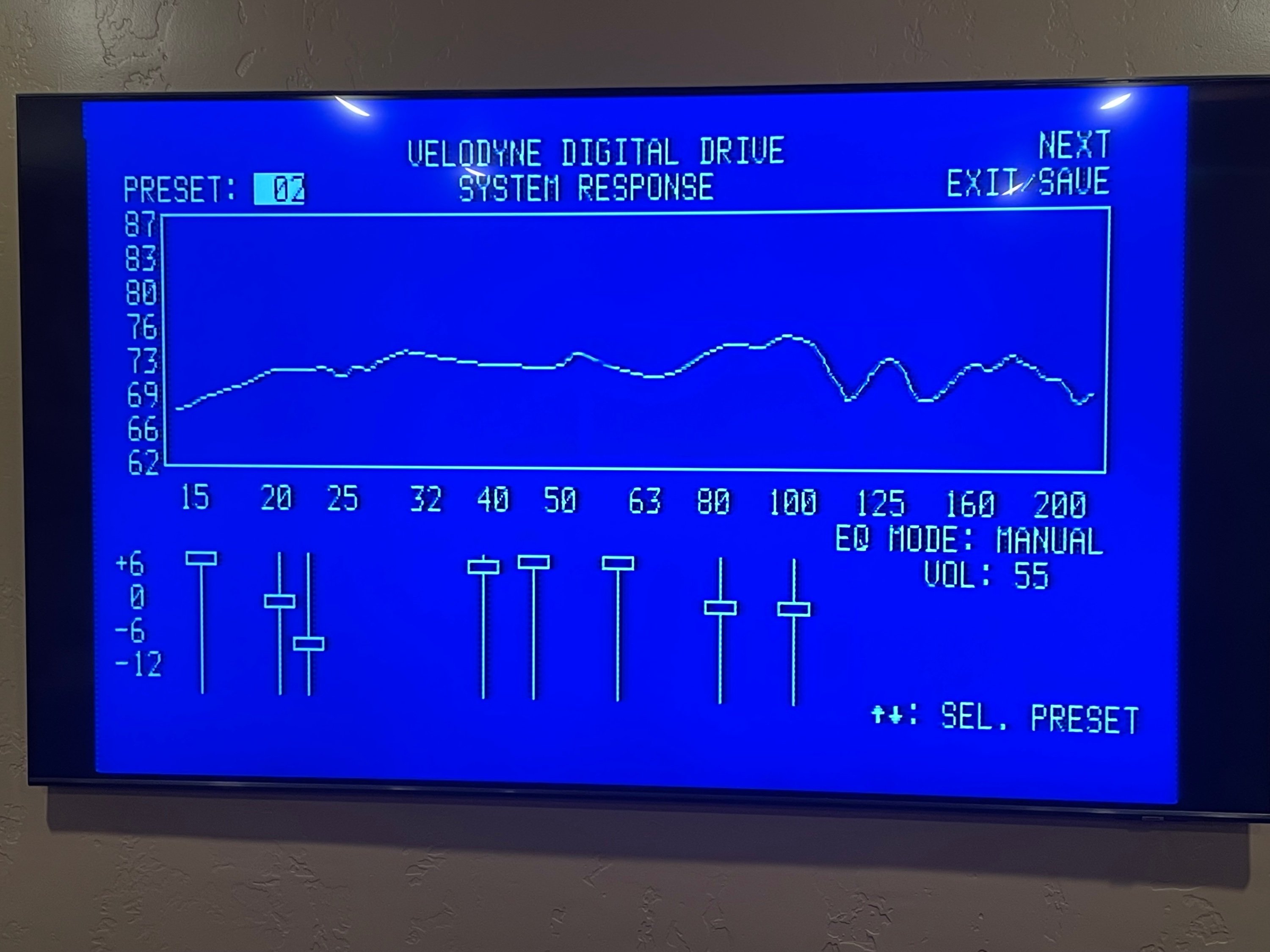

As a solution to all of these headaches, I purchased a Velodyne SMS-1 on the local classifieds. Anyone that has used one of Velodyne’s DD series subs has experienced the electronic tuning interface.  It’s a brilliant system that feeds a sweep tone (and on-screen GUI) into an input of your pre/receiver, then utilizes a microphone to measure the sweep tone, displays the results on screen and allows a plethora of adjustments via an 8 band parametric EQ.  The SMS-1 takes this electronics suite and puts it in a stand-alone component that goes in the equipment rack (mine is on top of the power conditioner on the left).
Well….  Even with the SMS-1, I wasn’t getting anywhere near the bass response I wanted.  My frequency graph looked more like a hockey player smile than anything resembling a straight line, and I had no “punch” or “impact”.  So I decided to move my Velodyne DD18 into the room (back left corner), bringing me to 3 subs in a 17’ X 13’ room.  The DD18 has its own electronics suite, so I just fed it from one of the “through” outputs of the SMS-1.  I set the DD18 low pass at 45hz - just looking for it to fill in the lowest of the Lows.  I was still not getting what I wanted, when it hit me - phasing.  I have the Klipsch RF7 mains playing down to 60hz, the SVS pair playing up to 80hz, and the DD18 playing below 45hz.  So I switched the SVS pair 180 degrees out of phase.  Boom - everything fell into place.  I now have a VERY flat bass curve.  I “think” that the SVS pair is now cancelling out any overlap they have with the RF7 mains, and the DD18 is cancelling out its overlap with the SVS pair.
another benefit of the SMS-1 is SIX (6) presets. So for movies, I have a couple settings with various bumps at 40hz, 50hz and 60hz, and for music a couple that are pretty flat.
heres the curve (I didn’t take a shot of the pre-phase shift, but trust me - it was BAD…

Your component rack is different than the custom one I remember. Did you make this one or buy it?
  • Thank You 1
The old one was too wide to accommodate the dual subs up front, so I had to make a new one. 3/4” oak plywood stained black with 5/8” threaded rod supports.  The center channel tweeter is EXACTLY the same height as the mains (I’ve learned that this is one of the most important elements of a cohesive front stage).

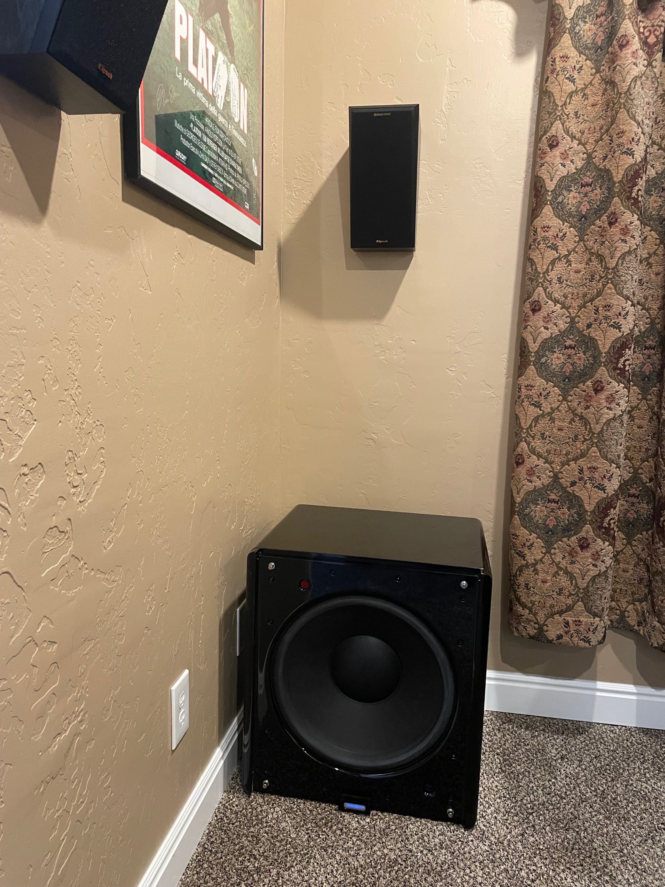

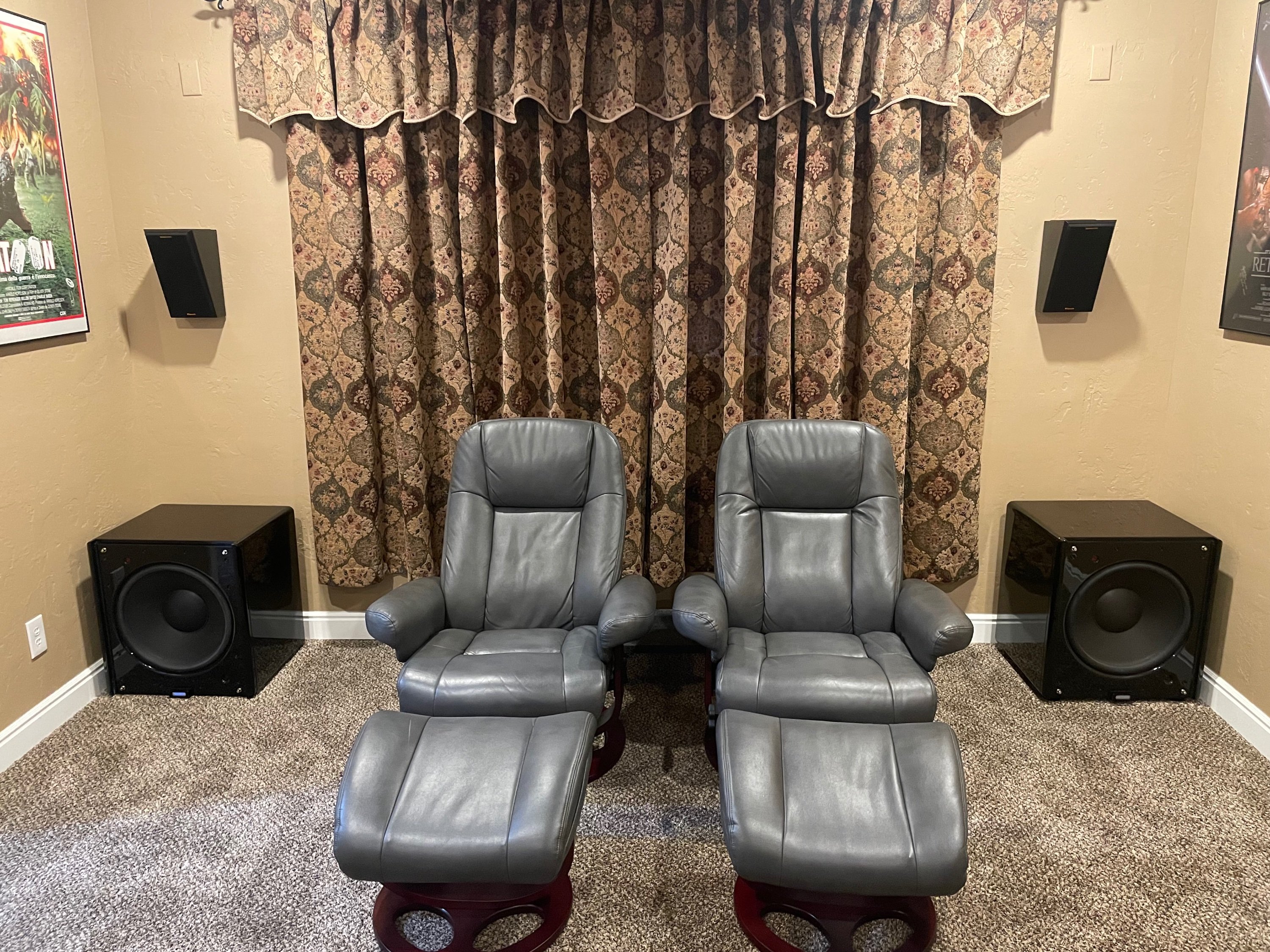

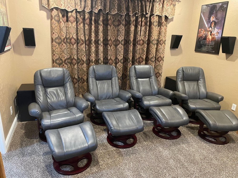

Well.
If a little (or a lot) is good, then a whole lot more is great.  Right?
In the case of bass in my HT, the answer is a resounding YES!  I had my 2nd Velodyne DD18 just sitting around collecting dust. It got wet in the flood about a year and a half ago, and to be honest I was afraid to plug it in.  With some of the proceeds from selling my 2nd pair of Silver 9ts, I sent the plate amp off to EBC in New Jersey. They are reasonable ($400) for plate amp repair/refresh, and do great work.  Even if it wasn’t damaged, the amp is getting on past the 30 year old mark, and due for some attention.
Well, I got the amp back a couple days ago, so today was the day.  Had a bit of a panic and detour that I’ll detail in another thread, but after some ingenuity I got it up and running.  I now have a 7.4.4 HT system, with two SVS SB4000 and TWO Velodyne DD18.  Don’t get me wrong, the SVS are very nice and stout subs, but the Velodyne DD series…. They are on a whole different level.  An 18” Kevlar cone (that’s just about 255sq inches) with a TWO INCH peak to peak excursion, and a 1,500 class D amp… they move some air. By comparison, the SVS uses a 13” driver (133sq inches) with a 1.25” excursion.
playing Top Gun Maverick, Lord of the Rings (the underground battle) and Days Of Thunder (all on 4k), I’m in bass heaven. The two Velodyne subs are kind of hidden behind the seating, but they make their presence known when called upon….
