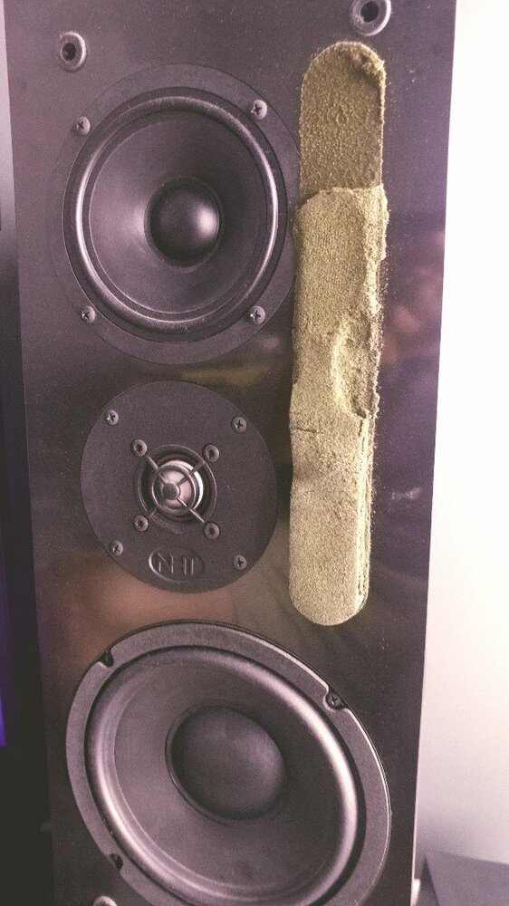

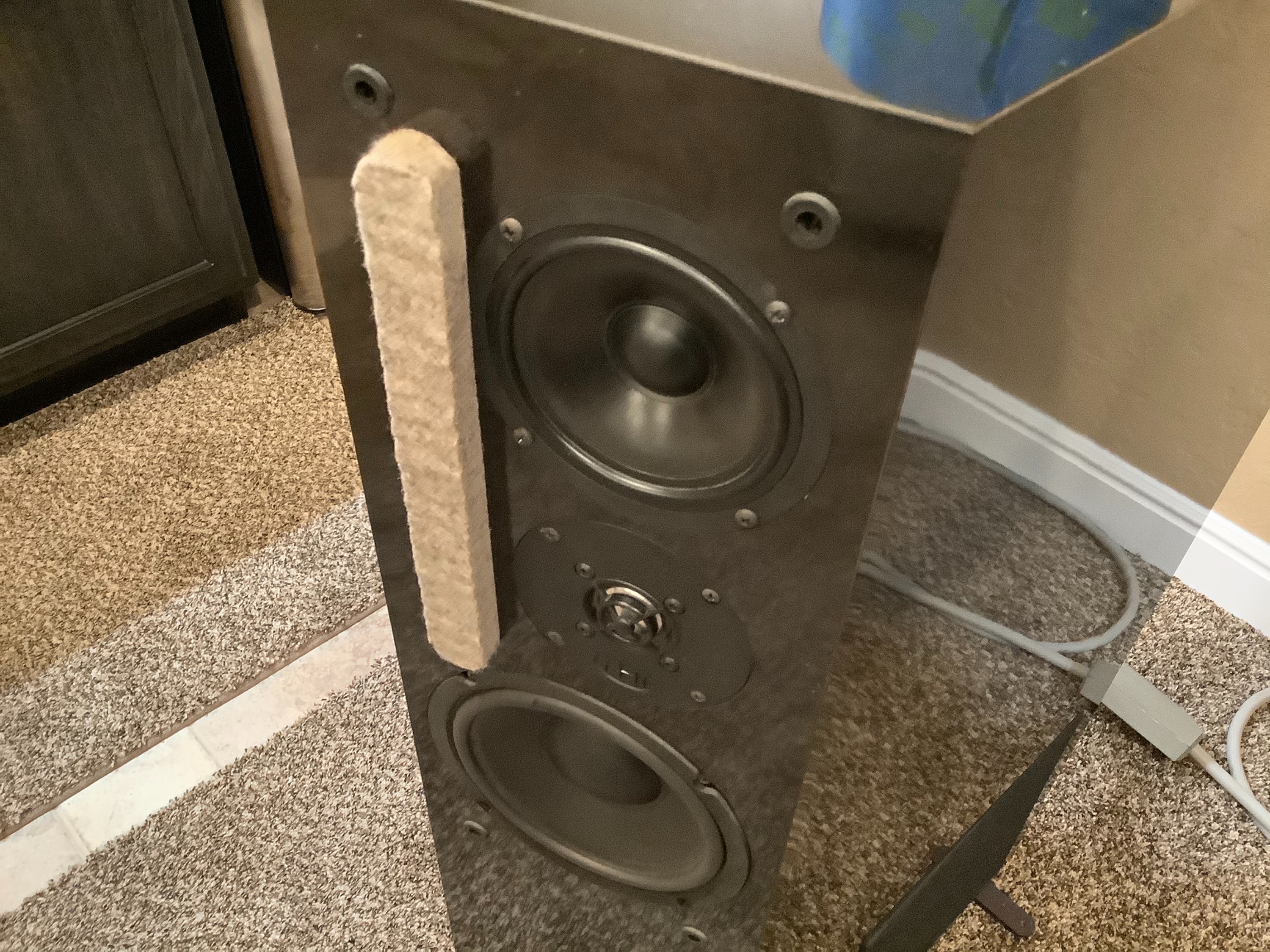

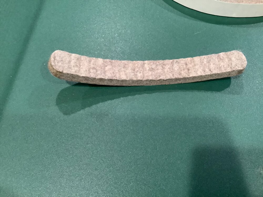

Daddyjt 10,065 Posted November 6, 2020 Posted November 6, 2020 About the only Achilles Heel I’ve run across on the NHT speakers is the strip of diffraction foam that many models (2.5, 2.9, 3.3, etc) have running outside the tweeter/midrange drivers. The foam tends to degrade and crumble over time, creating quite a mess. I have been experimenting with various materials, and I have settled on a solution - 1” wide x 1/2” thick adhesive backed felt. I tried open cell foam, closed cell foam, EPDM rubber stripping, and felt. I left one speaker with the stock foam, and compared it to the other with the various other products. The felt is by far the best compliment to the speaker, even sounding better that the original foam - degraded as it was. The worst part of the job is removing the old foam. It tends to come off in a crumbly, tar-like goo that’s just gross. I used denatured alcohol to soften and remove the base adhesive. the whole removal process is MESSY - be prepared. The felt came in a 10’ roll for about $20. I cut the strips to length and rounded the top and bottom on my disc sander, and trimmed the stray edges. The felt is 1” wide, as I said - the original foam strip was 1.25” wide. Therefore, I mounted the new, narrower strip the same distance from the drivers, leaving the extra 1/4” on the outside. @PhilDent I will be sending you a set for your 2.9 pair.:-) 3 7 1

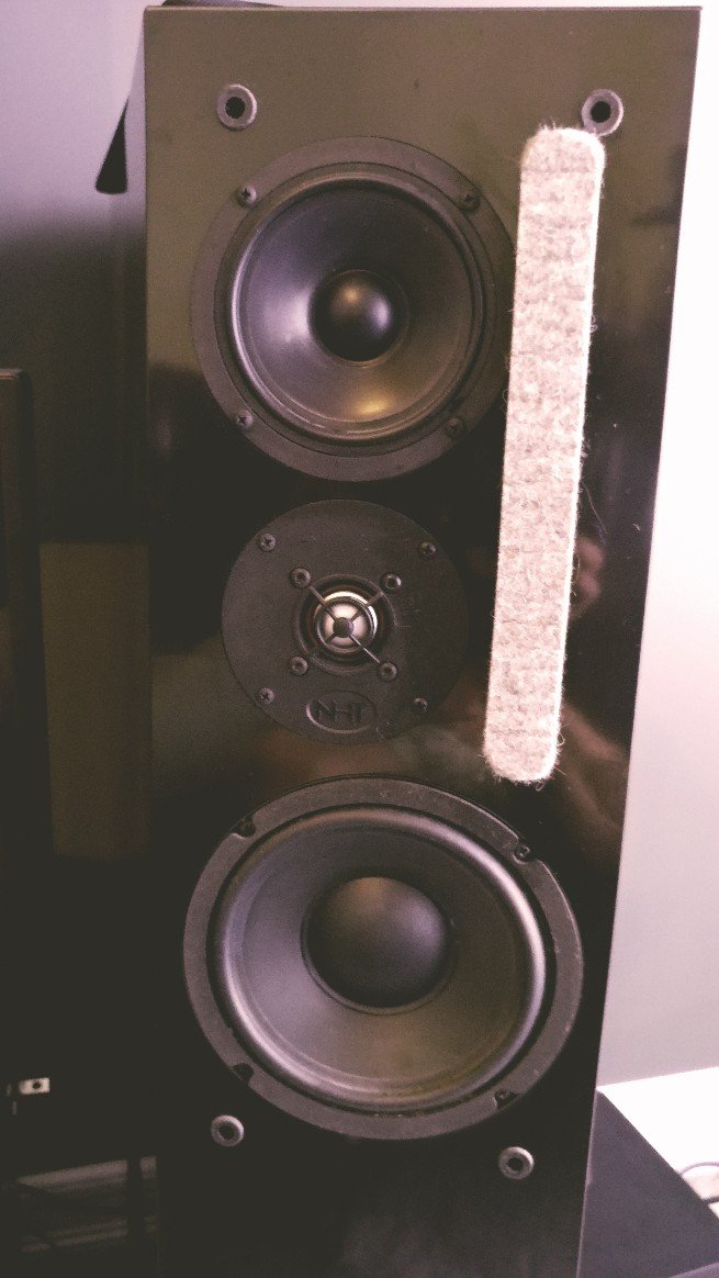

PhilDent 2,040 Posted December 1, 2020 Posted December 1, 2020 Got around to removing the gooey mess of the old NHT diffraction strips. Thanks to Mark @Daddyjt they are now refreshed. 2 4
Daddyjt 10,065 Posted December 1, 2020 Author Posted December 1, 2020 43 minutes ago, PhilDent said: Got around to removing the gooey mess of the old NHT diffraction strips. Thanks to Mark @Daddyjt they are now refreshed. Wasn’t that the gooyest mess!? Looks good man:-) 4

Receiver2000 5,361 Posted December 1, 2020 Posted December 1, 2020 Does the white strip show through the grille material? 2
Brian_at_HHH 2,754 Posted December 1, 2020 Posted December 1, 2020 I'm going to guess, that like @Sk1Bum, with my ears, I probably won't notice any real sound difference, but I am convinced that the foam NHT used self destructs. I don't think I've ever seen a currentish picture of a NHT where they weren't in a semi- or mostly dissolved state. Mine certainly are, and just the thought of something decent, in their place is something I'm looking forward to. @Receiver2000, I'll try to take some pictures of the results, to post, so you can see if the "pantie lines" show. 5
Brian_at_HHH 2,754 Posted December 18, 2020 Posted December 18, 2020 On 12/1/2020 at 12:03 PM, Receiver2000 said: Does the white strip show through the grille material? Sorry for the delay on finally responding to this, but I've now gotten that horrid slimy, gooey godawful mess off my speakers and Mark's felt solution in place. I've dealt with some really gut wrenchingly gross things in my life, but I can honestly say, the feeling of that stuff was jus about the grossest thing I've ever touched! Shudder! 🤮 Now that it's done, I can definitely say, that "no, one cannot see the light coloured felt through the speaker grills: The fist picture shows what can (or rather cannot) be seen through the grill, and the second is a peak under that grill. Now I did try to really enhance the 1st pic, to try and force even a trace to be visible, but Nada, nein, nope, nothin'. And just for giggles, here's one of my impromptu cat-scratch-excluders. I'm just using a melamine shelf (poorly positioned here) to protect the side woofer, when not in use. Try to ignore all the reflectons of @#$^ in and around the speakers - that's the downside of a shiny black finish. BTW, just a reminder to anyone doing this kind of work: brass screws look very nice but brass is DECORATIVE ONLY - DON'T TRY TO USE IT FOR STRUCTURAL PURPOSES. You would think I would know that by now, but the allure of "Oooooh Shiny!!!!" got me once again! Doh!!!! Trust me, here, just don't do it. Nice shiny stainless STEEL looks Perfectly good - really! Brass bad, Steel GOOD! Just repeat it as a mantra when building things. Lesson learned again ... until next time.. 🤪 Thanks again to @Daddyjt for the fantastic solution to that awful, self dissolving foam that NHT used! 2 3 1
