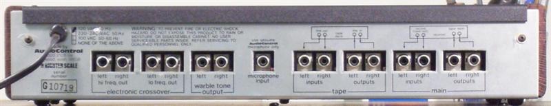

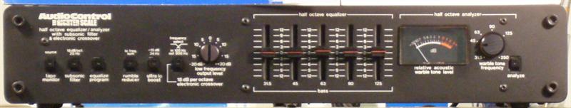

zumbini 6,150 Posted January 5, 2011 Posted January 5, 2011 I like the Audio Control Richter Scale for an application like yours. The original has a selectable 18dB/octave XO (100 or 800Hz) and sells for $50-100 on ebay. The Series III uses a readily available 16 pin DIP resistor network to change the XO frequency. Figure on paying $100 (w/o cal mike) to $200 (complete with box and manual) on ebay.
BillD 239 Posted January 5, 2011 Posted January 5, 2011 I bought a Richter Scale III from Z and use it with my C-4000 in my office system to drive my M&K sub. It works great.

zumbini 6,150 Posted January 9, 2011 Posted January 9, 2011 I found this Richter Scale Series III on ebay but it's local pickup only (CO) and it's missing the cal mike. The Behringer CX2310 utilizes 24/dB/octave Linkwitz-Riley crossover filters. Most of the time I fed my Richter Scale from a tape or processor loop and sent the sub out to my amp(s). In my current quad-amped setup I use a Behringer CX3400 located between my preamp and amp(s).
