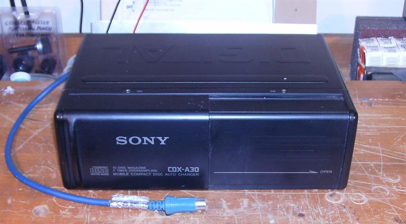

zumbini 6,154 Posted May 26, 2014 Posted May 26, 2014 I've used a Sony CDX-A10 CDP in the car for almost 30 years and have never had an issue with skipping. The XA-10B 10-disc magazines protect the CDs and I store the spare mags in the house when not in use. However, every CD my ex ever borrowed came back scratched, and some of those would skip. I had about a 90% success rate polishing them out using 3 part Novus plastic polish. Most discs I polish by hand but for the really bad ones I break out an orbital waxer/buffer.This is the same product I've used to restore turntable dust covers and M-500(t) meter lens. 1
