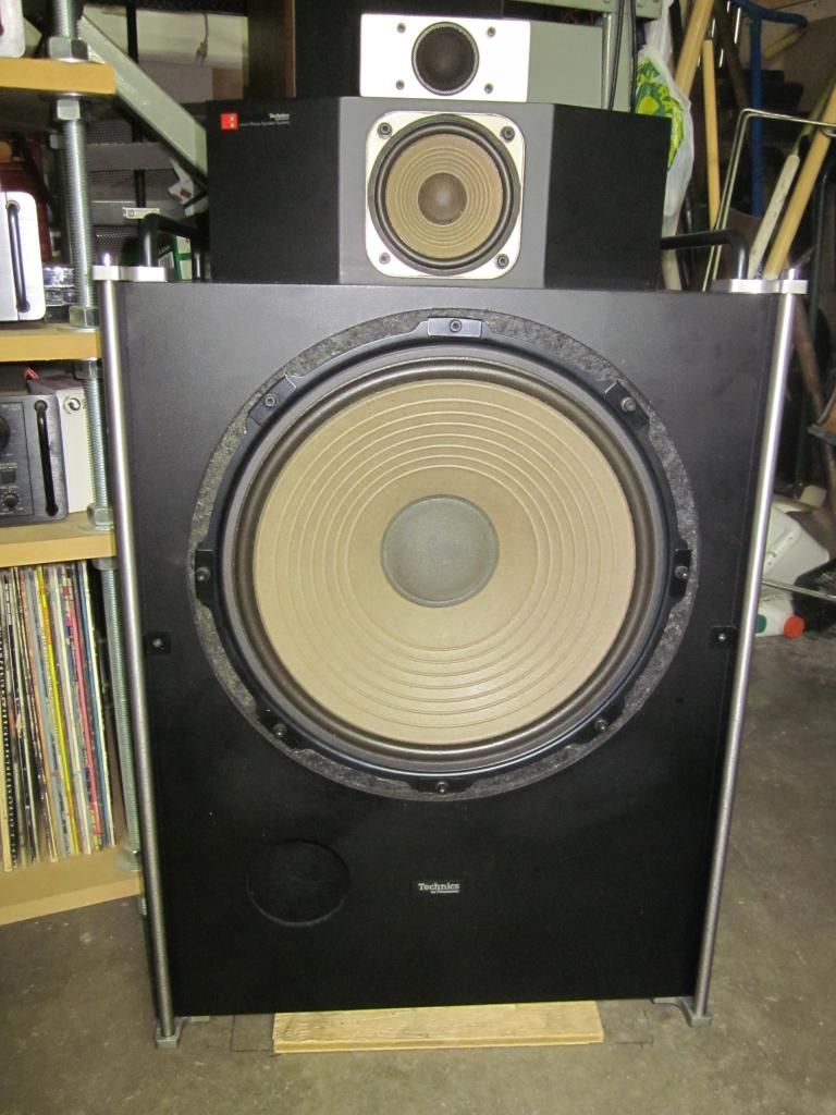

madmike46 445 Posted July 31, 2014 Posted July 31, 2014 Hey guys check these out. I got these going for a buddy of mine, they are a pair of Technics SB-7000a. I had to repair both tweeters, voice coil wire was broken from flex wire going to the terminals. I also gave them a good cleaning, they came from a smoking environment all the parts that are silver now used to be brown. I have been listening to these for a couple of hours now, really nice deep tight bass and crisp clean highs with a well rounded mid range. I might have to try them out with my tube amp. Here are a few pictures.

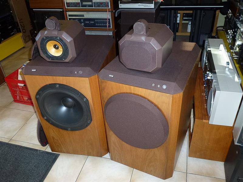

Daddyjt 9,897 Posted July 31, 2014 Posted July 31, 2014 Very nice - looks like they may have inspired the B&W 801 series...
fill35U 1,848 Posted July 31, 2014 Posted July 31, 2014 Nice score, Mike! Isn't there supposed to be foam on the surface the mid sits on, to control reflections?

madmike46 445 Posted August 1, 2014 Author Posted August 1, 2014 Nice score, Mike! Isn't there supposed to be foam on the surface the mid sits on, to control reflections? Yes there was it was disappearing as you touched it. I am amazed that the woofer and mid surrounds are still in great shape.
