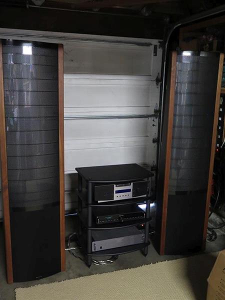

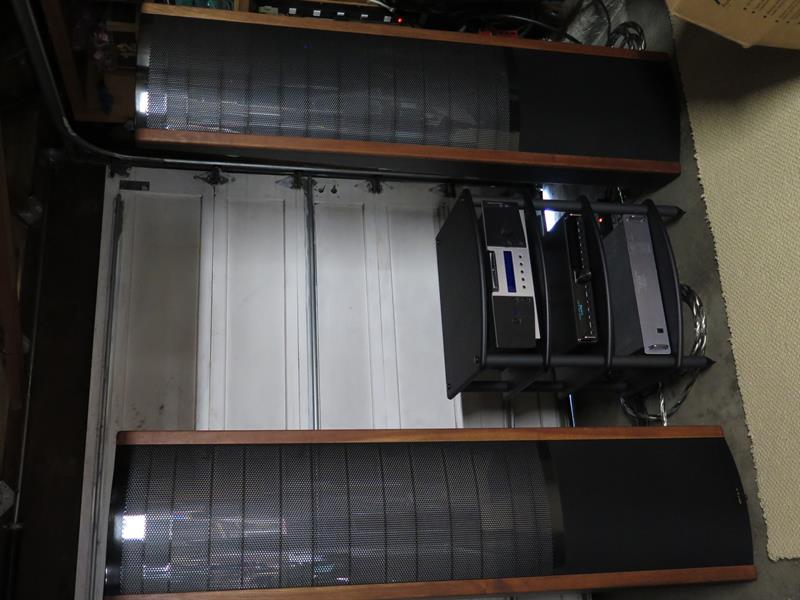

wrf 5,336 Posted April 10, 2017 Author Posted April 10, 2017 Almost forgot. Here's a photo of the speakers. Actually they aren't really lying on their sides. Seems that the photo uploader has a mind of its own. It's right side up prior to uploading. Maybe the site remodeling can fix that. 2

loner_t 2,572 Posted April 11, 2017 Posted April 11, 2017 Actually they aren't really lying on their sides. Seems that the photo uploader has a mind of its own. It's right side up prior to uploading. Maybe the site remodeling can fix that. Z is reading this thread. He will usually correct the EXIF data and re-upload the image with proper orientation.
zumbini 6,154 Posted April 11, 2017 Posted April 11, 2017 Heck of a deal Wayne, and an easy fix too. ENJOY THE MUSIC! ...Actually they aren't really lying on their sides. Seems that the photo uploader has a mind of its own. It's right side up prior to uploading. Maybe the site remodeling can fix that. As I've noted previously, most digital photos include EXIF data that includes the orientation of the camera. EXIF compatible programs read the EXIF orientation tag and automatically rotate the image view to match. Unfortunately Cute Editor (the forum's image editor) does not recognize/support EXIF orientation tags. As a result a photo taken with the camera/phone in portrait mode is displayed in landscape mode. To fix it I downloaded your image, opened it in IrfanView, removed the EXIF tag, and saved the edited photo. Here's the edited image which now displays properly: 2
wrf 5,336 Posted April 11, 2017 Author Posted April 11, 2017 Thanks. Now I can go back to the garage and listen some more without laying on my side...... 2
