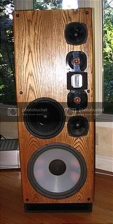

Brian_at_HHH 2,706 Posted June 23, 2019 Posted June 23, 2019 For many years I was firmly in the bigger/more is better, camp. While not huge, my main speakers had 10" woofers and were 5 way to spread the load. I always assumed when it was time to upgrade, I'd be going for something with 12" to 15" at the lower end. When I actually did go and look for an upgrade, it was apparent that the bigger/more is better, was not a valid assumption - something those with Polk speakers have known for ages. It's about being able to move the necessary air - whether by one big or multiple smaller drivers - both approaches work well. Also, more drivers at different frequencies don't necessarily work better. For what it's worth, I went from Sansui SC-45's (5-way/10" woofers) to Mission M74's (2-way/dual 6" woofers). There's no comparison, between them. All of the other speakers that made my short list, were in the same sort of size and style. The big boys got left in the also-ran group. Does that mean big speakers aren't or can't be great? No - there just weren't any I found in my price range, that could touch the sound of the smaller, more refined speakers I found. I have since added a sub, and very recently upgraded to a much better one (thanks Raven), and I find it makes a huge difference. Like @kve777 I do turn the sub off, on occasion, but I usually go running back for the on switch, because the sound just feels lacking by comparison. 5

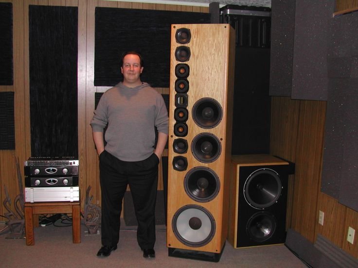

Daddyjt 9,648 Posted June 23, 2019 Posted June 23, 2019 No matter how big the bass drivers in your main speakers are, I believe a sub is invaluable. I use a sub with everything, even my Legacy Focus pair, and they have 3x 12” woofers per speaker. 7

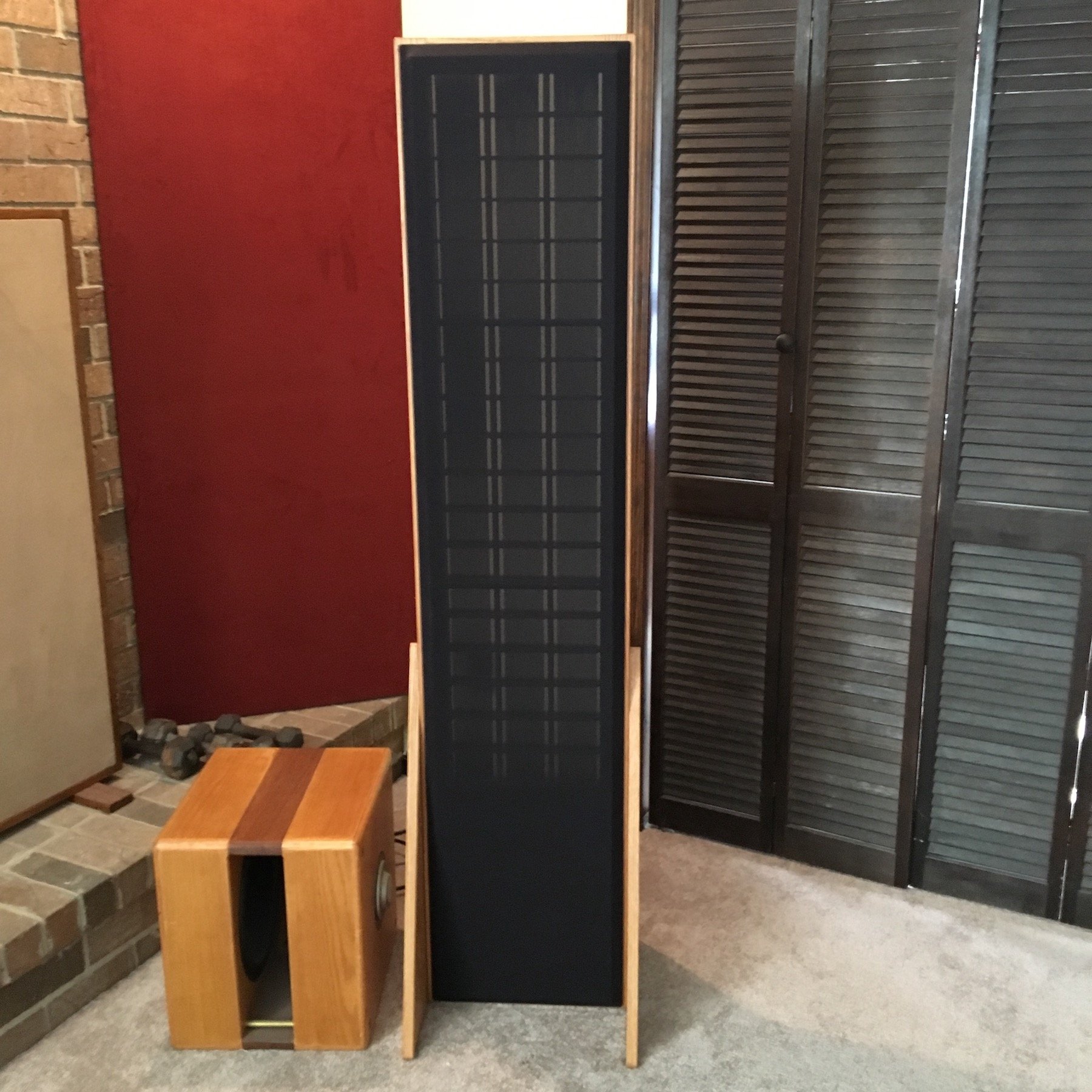

jazzman53 1,276 Posted June 3, 2020 Posted June 3, 2020 I have a pair of these Ripole subs crossing in down low at 60Hz---- unobtrusive and seldom noticed unless I kill their amp and then their absence is immediately apparent. But when I play something with profound bass, like Bela Fleck's Flight of the Cosmic Hippo, it's like WOW...that's LOW and CLEAN! 1 4
